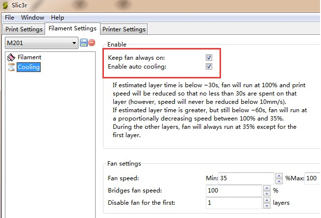

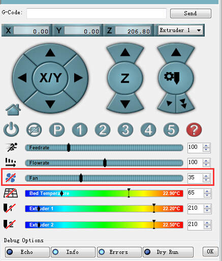

actually there a PWM fan connector on your board, it can be controled by the repetier host and in the slic3r settings. Plug the fan in that connector and you'll turn it on and off or change the speed here:

Yes, i know these settings allready but ther system doesnt respond to any tick change. The fan is always on with the same speed. These settings i am using from the beggin. This is why i am wondering what is wrong... MAybe the firmware?

Nope, it depends on the gcode you generated, usually it is the same speed.
