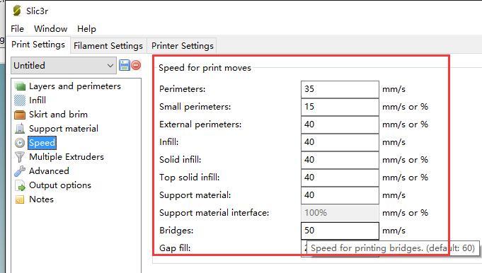

2. the speed in the slic3r settings, are they too fast? you need to set a proper speed for different layers and primeters:

but in the first 2 minutes the bridges fill speed was normal and then it freaked out and sometimes it freaks out just at the beggining and the bed hit the end so i have to emergency stop
