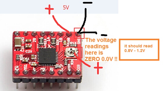

The X axis has some "jettirng" effect when coming back to HOME position! it goes to right smoothly, but when it go back to the left it jeters and that effect the printing and through the extruder carriage off the printing path!
I connected the other motors to see if there is something wrong with X motor, but i found out that all the motors do the same thing! so, all the motors are good. the problem appear to be from the board!
I DON'T KNOW WHAT TO DO?!?!? :roll:
Thanks for any help in advance!

1. check your assmbly, if the rods are paralleled
2. check the stepper driver board, if the Y axis moves normally, you can exchange the driver board of Y axis to X aixs, if the problem solved, it must be the problem of driver board.

I did that!
the output from the BOARD is not good!
So, How would you solve this problem?
since your company sell and ship out defected parts!

what is the out put of the board? Driver board or GT2560?

As the picture indicates .. these are the voltage readings on my board!
The voltage is Zero!!

what kind of wiring are you using ? If you are using that Dupont connector type of connector on the end that could be the problem as there not very secure and if one contact is bad it could cause intermittent contact problems .
