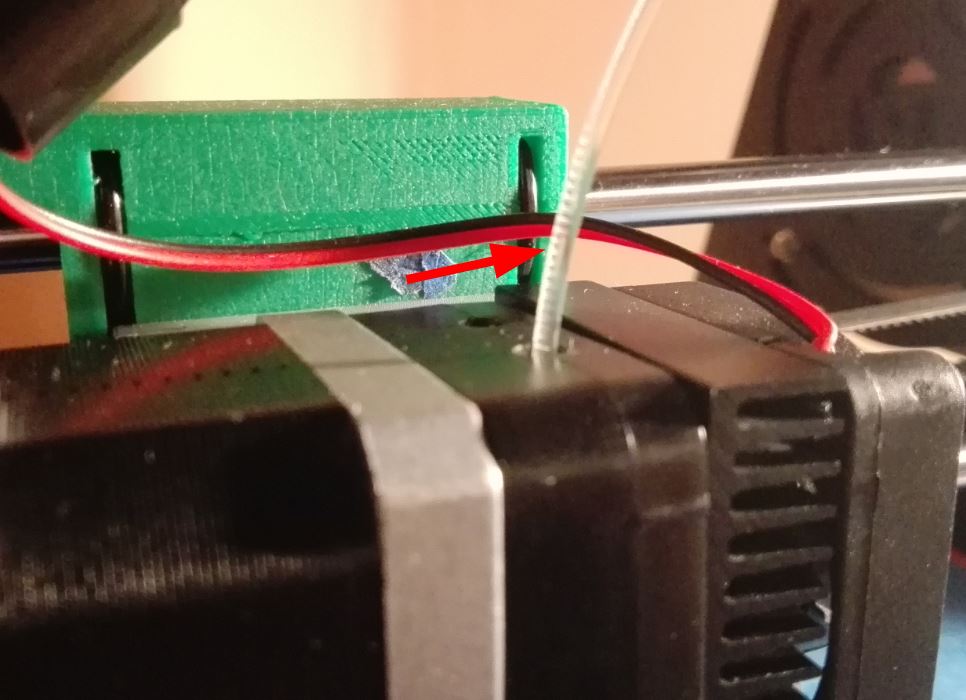

I have a Prusa I3 Pro B printer with 2560 rev a controller board.
i have a 3 problem.
1: The printer not connec with Repetier host. I think peoblem with the baud rate. How much the origonal baud rate?
2: I print with SD-card. Make one-pair layer after Stop the machine (in process) and stop printing. why? What do you think how to solve? Maybe firmware refresh?
3: In print process if not stop the machine ( Like 2poit :) ) go out the filament after continue the printing without filament... The motor is work only the filament stuck in the feeder. Picture:
Thank you for your help!

1. the baud rate for this printer is 250000, you can check the user manual to set up the printer.
2. Regard to question 2and 3, I think maybe the slic3r settings of your printer are not proper, you can use my settings here:
I3 B-PLA-0.4-1.75.zip
