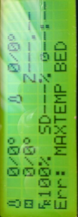

the board shows err max temp but the display does not indicate temp just 00
Re: control board problem
Hi,chrisprint wrote:the board shows err max temp but the display does not indicate temp just 00
Have you already checked the link i posted?And could you take a pic of your LCD ?
chrisprint
- Posts: 7
- Joined: Wed Jun 15, 2016 12:53 pm
still no result
- hope you get this
- _20160618_172819_1.JPG (20.88 KiB) Viewed 13192 times
Hi,my friendchrisprint wrote:still no result
I think you'd better try to check it again as the links shows,maybe you've missed something.
Good Luck!
