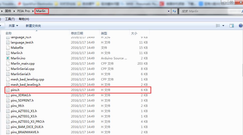

You can find the "pins.h" in your own Marlin firmware and then open it in your notebook,which may work:

I can open the pins.h but i don't see the gt2560 board on the list, i searched for half an hour.

OK,i actully mean you can make a compare to the pins in "pins.h" of our GT2560 with your pin layout of the Ramps 1.4,and make a reference to the diference.

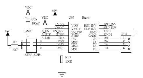

Do you have a diagram mapping the A4988 pins to the Atmega 2560 pins?
Right now i have only a battery 18V 3A and 1 stepper motor connected to the board. If i run a testprogram there are 3 red led's which flash during the program, the motor is not moving.

Re: pin layout for gt2560 board
Here is the diagram:
