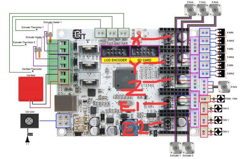

Hi,here are some tips:

Where can I find what driver board actually goes to which channel?
I don't entirely understand what you exactly mean,i guess you wanna know which A4988 controls what motor?If so,look the pic i attached:

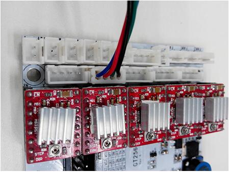

4.You'd better swap the driver of the problem motor with other axis,take note of the A4988's direvtion when you're plugging it,the board will burn out if A4988 has a wrong direction,a right direction should be this:
