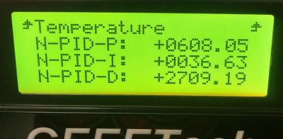

Hi, I have uploaded a new firmware following the step-by-step instruction you posted. Unfortunately, no hope. Still the same problem. I also checked the PID parameters. They are exactly same as previous values. I added the image here. Would you please instruct me any further to fix the problem? Thank you very much.

Hi,khondoke wrote:Hi, I have uploaded a new firmware following the step-by-step instruction you posted. Unfortunately, no hope. Still the same problem. I also checked the PID parameters. They are exactly same as previous values. I added the image here. Would you please instruct me any further to fix the problem? Thank you very much.
You said "I kept it open for a longer time",how long did you wait for?The PID parameters in my printer are the same as yours,and my temp fluctuates about 7-8 degrees,i guess it's normal?BTW,my firmware version is 1.0.4

Hello, I think if PID values are kept constant then its not auto-tuning. I am trying to use a different extruder system with M201 printer. So, the PID values for this new extruder structure would be different than those of the original extruder came with M201 printer. Would you anyone please help me how can I perform auto-tuning using the M201 firmware so that I can get the optimum PID values corresponding to the new extruder system? I mean, how to do auto-tuning using M201 printer/firmware. Thank you very much.
