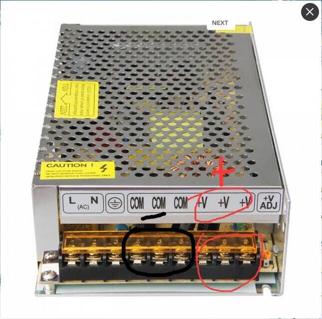

iamdbain wrote:I bought an Impressora Reprap Prusa i3 A Pro 3D and assembled it an had no problems except I was using an old SD card and it would not recognize it. You suggested I try a different SD card so I bought a new one and it worked first time. I printed a 20mm calibration cube with no problem. Two hours later I started my second print and was halfway through a filament holder (a 33 minute print) and the power supplied just died. The screen went blank, fan went off, and printer came to a complete halt. The power indicator light on the rear of the power supply shows it is getting power but the whole power and control unit is dead. I have not opened it to check for any burned out component but I was sitting right beside it and heard nothing, it just quit. Any ideas as to what I should do next.
You can measure the DC output(between +V and COM) of the PSU with a multimeter to see if it is about 12V,maybe the PSU has broken.

As you suspected, there is zero volts coming from the power supply. I did a simple continuity check on the fuse and it is not blown and I went all over the top of the board with a magnifying lens but could see nothing physical indicating a problem. It must be at the component level, something must have gone bad that is not visible. I did find a small round blob of solder (like a BB pellet) rolling around on the board top but it was in an area where it could not touch any two leads to short anything out.
A test video about the "DC output" would be appreciated.Thanks in advance.
