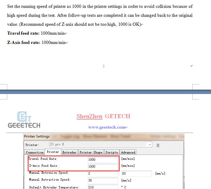

I think the speed recommended in the Pro B user manual is OK:

Hello William,
objection...
if you are reading this in sequence:
- Change the Repetier Host default value for the speed to 1000mm/min to slow down to check the motor direction
- "After follow-up tests are completed it can be change back to the original value
But the original/default value in Repetier Host is 48000mm/min (80mm/s) ... IMHO very fast.
On the other hand 1000mm/min (16mm/s) is very slow.
Do you mean 48000mm/min for X/Y Axis and 1000mm/min Z-Axis is recommed?
maybe someone from Geeetech can give a recommend value, or confirm the 4800mm/min value?
Thank you!
Greets Alex

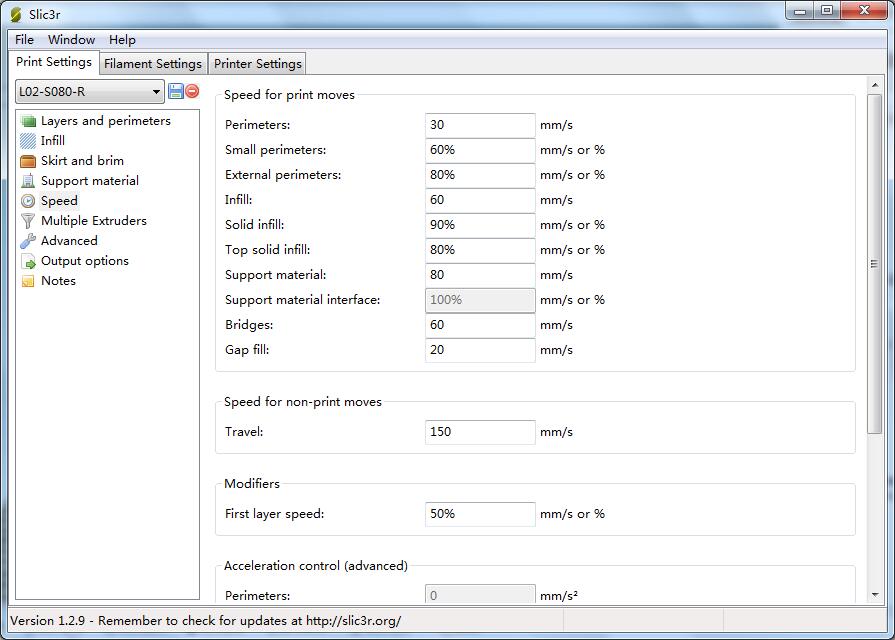

I guess i misunderstood your words.You mean the speed in slicer?
The speed in printer settings is just for test.
You can try loading the default config:
I3 B-PLA-0.4-1.75.zip
(1.35 KiB) Downloaded 977 times

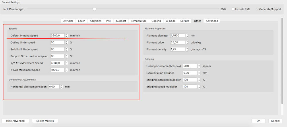

correct i need the maximum printspeed of the i3 Pro B,
no matter where I have to adjust it.
Is this correct? i use Simplify3d:
Bildschirmfoto 2016-08-26 um 12.20.41.png (145.39 KiB) Viewed 20572 times
Can you give me the correct value for each point?
Thank you!

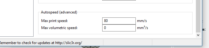

Sorry,haven't used the Simplify3d before,so i'm afraid i can't give you some constructive advice.
Max print speed 80 is OK.But i think default printing speed 3600 mm/min is too fast.You can try 2000 first,then print a small cube to test and adjust the speed little by little in the next continuous tests.
