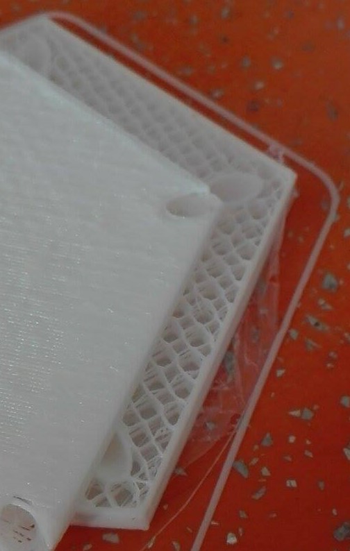

Hello recently I bought a Prusa i3 Pro B. Everything is working I printed out a few stuff, but during printing sometimes the x axis moves in starts the next layer, see in the picture. `
Do you have any suggestions of where might be the problem? Thank you!

bmdiyh wrote:Hello recently I bought a Prusa i3 Pro B. Everything is working I printed out a few stuff, but during printing sometimes the x axis moves in starts the next layer, see in the picture. `
Here is some tips:
1.Check the tightness of the timing belts,not tight and not loose.
2.Try changing another driver A4988 of the axis if you had a spare one.
3.Make sure your printing speed is not too fast.
