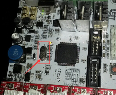

Re: x axis problem
Posted: Sat Sep 03, 2016 9:47 am
by Toy
Perhaps the crystal oscillator doesn't work on the board, you can check the voltage of the two pins to GND, normally they should be both be about 2V, the difference of the two voltage is about 0.2V

by Carlprem
Hi Toy,
I checked the voltages on the crystal as you said and got 0.72v on the pin nearest the USB connector and 0.83v on the other pin.

Re: x axis problem
Posted: Mon Sep 05, 2016 2:47 pm
by William
You can contact the seller for a replcement or you can solder a new crystal oscillator yourself,which will save a lot of your time.
