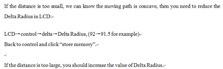

Hello, Where can I find explanations on what the " Delta " settings on my 301 do and how to set them . I am having a bad time trying to calibrate . The 1st layer is either too thin or too high to stick , it is very uneven from center to edges. It is also inconsistent , I get 1 decent print then the next day it is all out of order again. Please advise.
Re: Delta M301 firmware ( Marlin )
Posted: Fri Sep 23, 2016 5:23 pm
by William
divemasterbill wrote:Hello, Where can I find explanations on what the " Delta " settings on my 301 do and how to set them . I am having a bad time trying to calibrate . The 1st layer is either too thin or too high to stick , it is very uneven from center to edges. It is also inconsistent , I get 1 decent print then the next day it is all out of order again. Please advise.
Hi,see the picture:

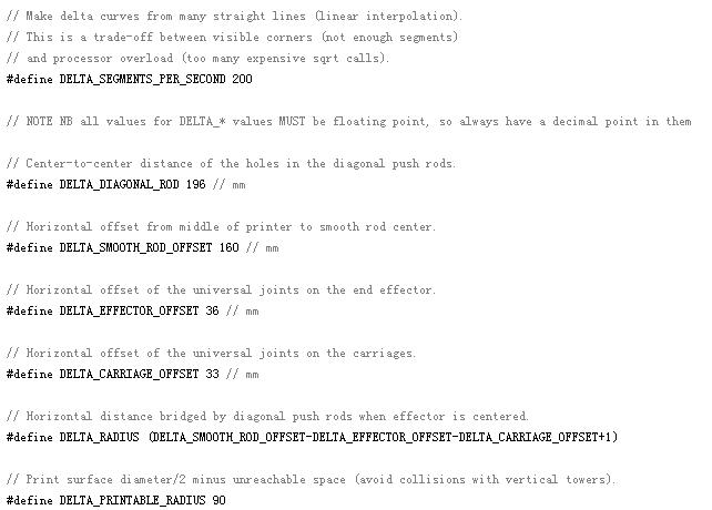

Where do I find definition / purpose of all the "Delta" settings ex; diagonal rods , smooth offset , effector offset, carriage offset, Delta radius,
Posted: Mon Sep 26, 2016 6:28 pm
by William
divemasterbill wrote:Where do I find definition / purpose of all the "Delta" settings ex; diagonal rods , smooth offset , effector offset, carriage offset, Delta radius,
Here is the relevant settings in G2s's firmware,you can refer to it:
