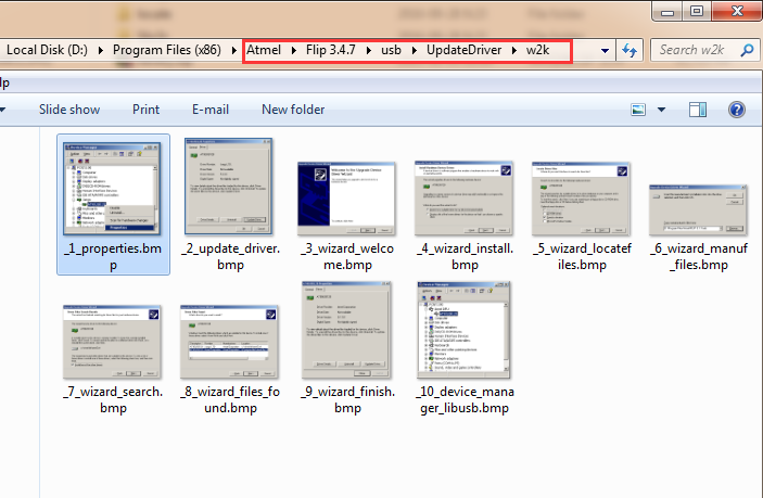

Re: Flip uploading
Hi Rob,
There are the instructions to install the driver in this path:
Atmel\Flip 3.4.7\usb\UpdateDriver\w2k You can update the driver according to the info there.
