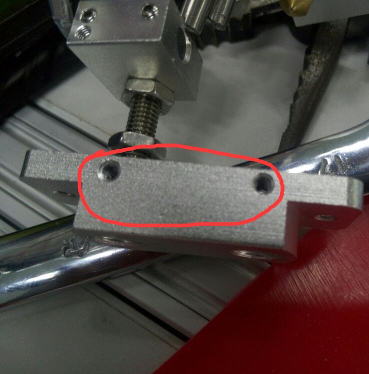

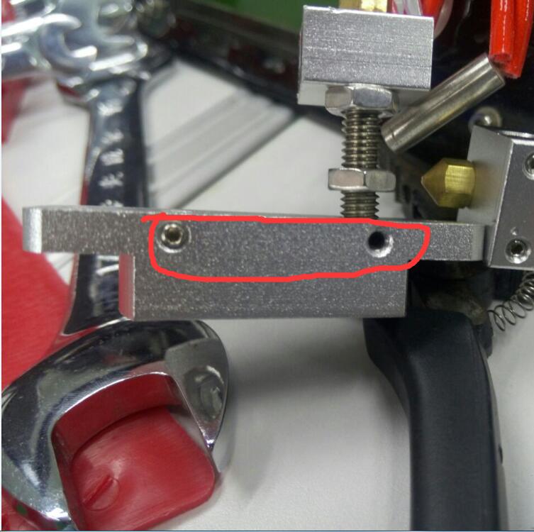

Re: Nozzles levelling on g2s pro
You can unscrew the 4 little screws(see the pictures) with a tool on the two side of the block first,then it's free to move the barrel(nozzle throat) up and down.
So you can adjust the position.

I have the same problem as AndrewS.
I have the aluminum block, but there are no screws in it.
I can loosen the two nuts, and turn the barrel by hand, but of course, the end in the block screws out, and the end in the heater/nozzle block screws in, keeping the nozzle height the same.
Are the set-screws in your illustration tightened againt a smooth surface on the barrel or against a threaded part?
