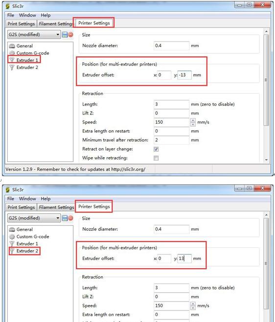

I'm not sure what exactly your problem is.Did you set the right value in your slicer settings:
Also,a video about the issue would be appreciated.
