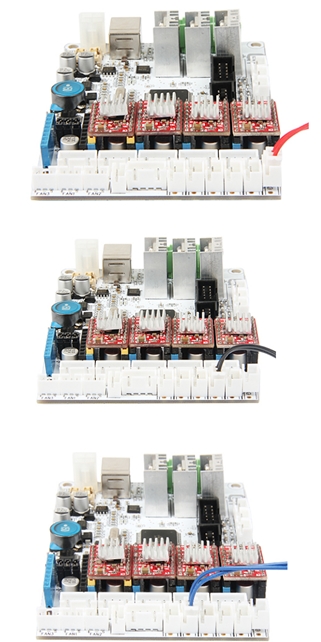

Probably not...You can check if you have endstops correctly connected(X-1,Y-3,Z-5),have a look at the following picture:
endstop wiring.jpg (135.73 KiB) Viewed 8704 times
