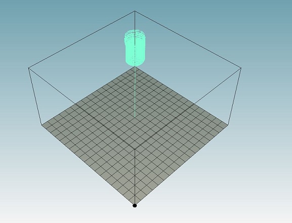

Centered to Home Position for printing.JPG (65.14 KiB) Viewed 6581 times
Yes ... it seemed to work as I imagine it should ... except it only left the 'home' position ... and began printing slightly overhanging the front edge of the table ...
I'll check over the user manual and try to reconfigure the Repetier Host as you suggest ... I've been over it a few times ... but I guess I'm missing something ...

Did you select the right Printer Shape in printer settings?And did you "center object" after loading it?
