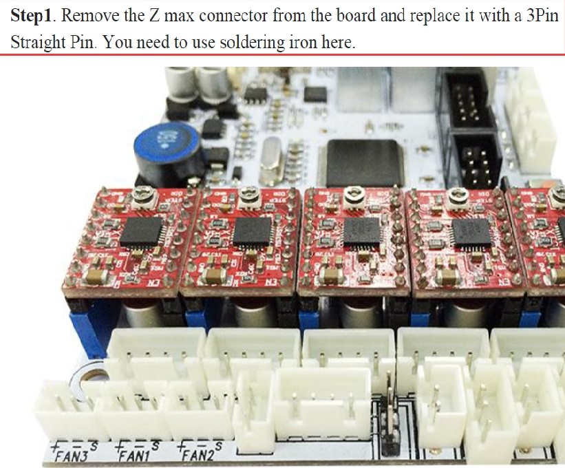

Today i brought BL Touch sensor for My I3 pro X.I read wiki and somany topics related sensor.
But my problem is My board have only 2 pin in Z maximum.how to make it 3 pin or any other place possiable to place 3 pin?
Please explain me

Hi,Shiva
Have a look at this picture,and refer to the manual of 3Dtouch:

Hi
this picture iSeen in wiki,But i get confuse where i have to solder 3rd pin.I guess next to 2nd pin there is place like small Dot is there.

by bang
1.You need solder 3-pin connector on "Z_max" position(you can see the printed chars on the back of the board).
2.I didn't find the entrance to type in the Gcodes in Cura,and i'm afraid you have to use Repetier Host...
