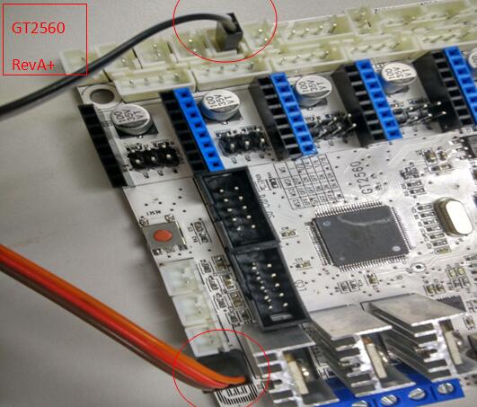

Good morning,
I installed the wiring as indicated in the photo, I made the changes in the firmware and it does not work. Sending GCODE manual code and no response.
What could be the problem??
Re: GT 2560 Rev a+
Posted: Mon Jan 30, 2017 5:09 am
by i72rugoa
I have done many tests and the problem is that S connection is not enabled. How could one enable ??? Is there a bridge on the GT2560 that enables it? Or maybe the firmware ??

@i72rugoa
Did you modify the code in "pins.h" correctly?Maybe you can attach this file.
