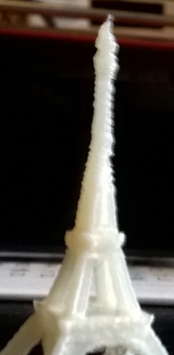

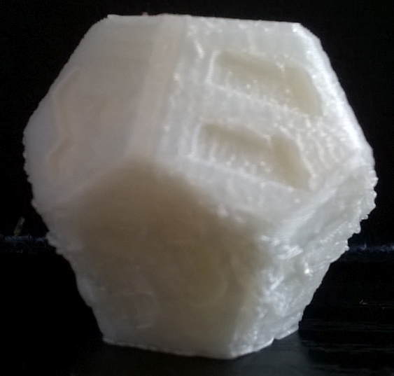

So, I tried 12 sides dice and Eiffel Tower, and results were bad (pictures enclosed)
- For the dice, the bottom faces (approx.. 20 mm) are completely disturbed, even if the higher sides seems corrects
- For the Eiffel tower, the small part on the top is disturbed.
A friend of mine suggest to lower the bed temperature to 55°C, but with no good result
Another suggest to add filament cooling fan(s).

My parameters :
- Geeetech prusa I3 pro B black Acrylic
- repetier-host v1.6.0 + Slicr3r
- PLA filament 1.75mm
- Extruder 210°C, bed 55°C
- Extrusion multiplier :1
- Layer height : 0.2 mm
- Disable cooling fan for the first : 3 layers
- First layer height : 0.3 mm
- Solid layers : 3

i have a prusa pro a,my prints looked like that,,
I fixed mine by installing Cura.
What did i do? I slice with cura,sent it to SD card,CLOSE cura and open Repetier.
Load the print that you put on sd card to repetier,,,go streight to print...Do not slice it again with repetier,just print.Also works in printer without computer,if you have that option.
Now mi printer dose wonderful prints,hope this works for you.
I thought my printer was messed up,but it was the software.
Hope this works for you.

I made some tests using CuraEngine instead Slic3r in Repetier : results are not perfect .. but lot better !!
- with 6 sides dice, results are perfect !
- with 12 sides dice (http://www.thingiverse.com/thing:578442), there are still some disturbances on faces going up outside, but lot less. Perhaps does it need some bridge ?
I tried also with 200°c / 65°C .. but with no better result
many thanks
Bertrand
