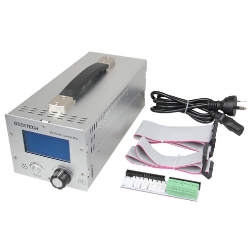

does anyone know where i can get a GT2560 extension board that comes with the 3-in-1 control box like in this picture below Image

bang
Posts: 402
Re: GT2560 extension board melted
Post by bang »
If that is the case,maybe you can ask the seller to resend it but at your expense?
