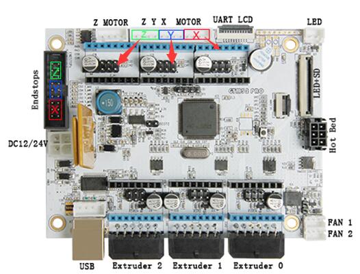

Do they booth motors (42SHD0034-20B) have only one step driver A4988 ? Can I adjust a Vref (on what value) that motors have more power ? Which driver on board GTM32pro is responsible for this ?

This pic has a good illustration for the driver:
