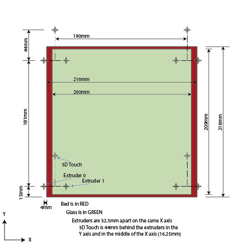

So, I have my printer up and running (just) but I am really confused over the X, Y, Z, probe position numbers.
Where - physically - is 0,0,0 ? Is it where the End-Stop micro-switches are, or is it the front corner of the heated bed, or the glass?
If it's not where the end-stops are, then how do I make the start of the X axis -4mm for the L/H extruder ?
Is everything measured from the Extruder 0, or from the middle of the extruders?

Here is a drawing of my Printer, Extruders, and 3D Touch (to scale!):
Printer Dimensions.png (16.26 KiB) Viewed 4973 times

Is "homing" the endstops, or a position on the bed? What do I set the X_MAX_POS to ?

Are these positions relative to the endstops, extruder, or the bed?

I can't find anywhere that AUTO_BED_LEVELING_3POINT is enabled, so I assume that the numbers in that section don't matter. However, I have played around with the UBL_PROBE_PT_.... numbers randomly until the compiler stopped complaining. What should the numbers really be? From what position? endstops, extruder, or the bed?
