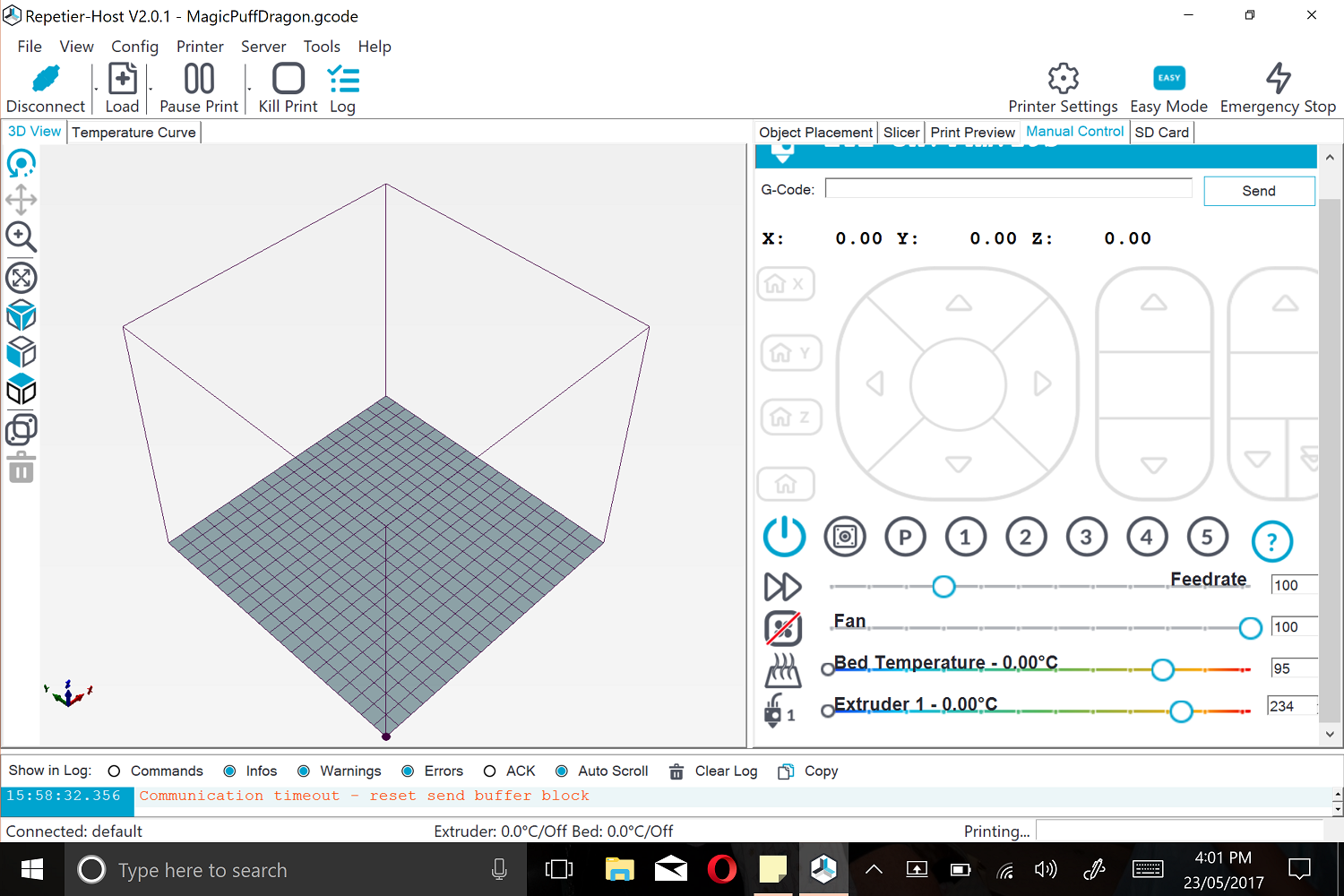

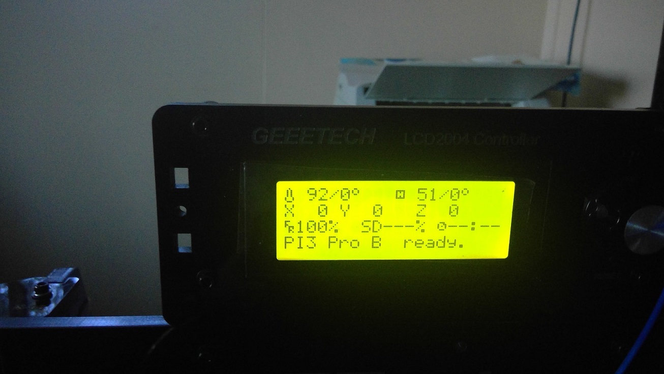

these are the messages im getting when i try to print dont take3 any notice of the temps i did that manually and it was still cooling down
I can move all the xyze through the lcd switch manually but i cant get it to print from either the reipieter software or through SD card the message i get as you can see from the pics is it the count timer goes up when i set it to print from sd but that is all
any help would be apreciated i have tried to change baud rate makes no difference
thanks
chris

Change the USB cable. Try to use a good quality one and as short as possible. I had some similar issues...it was stopping in the middle of the print showing that communication error. The problem was the cable which was too long.

Thanks to everyone for there input i have managed to resolve my problems and I am printing again with some good results.
ABS filament that im using is a bitch to get the settings right but im getting there
