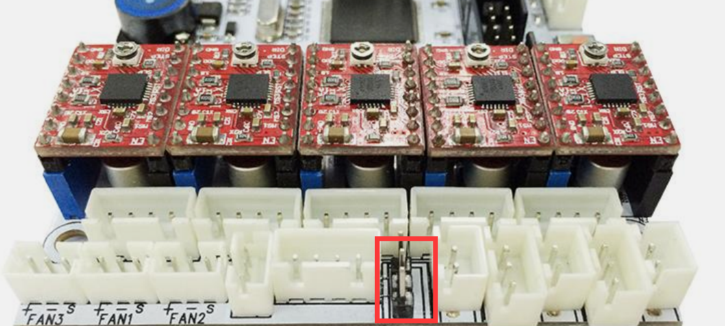

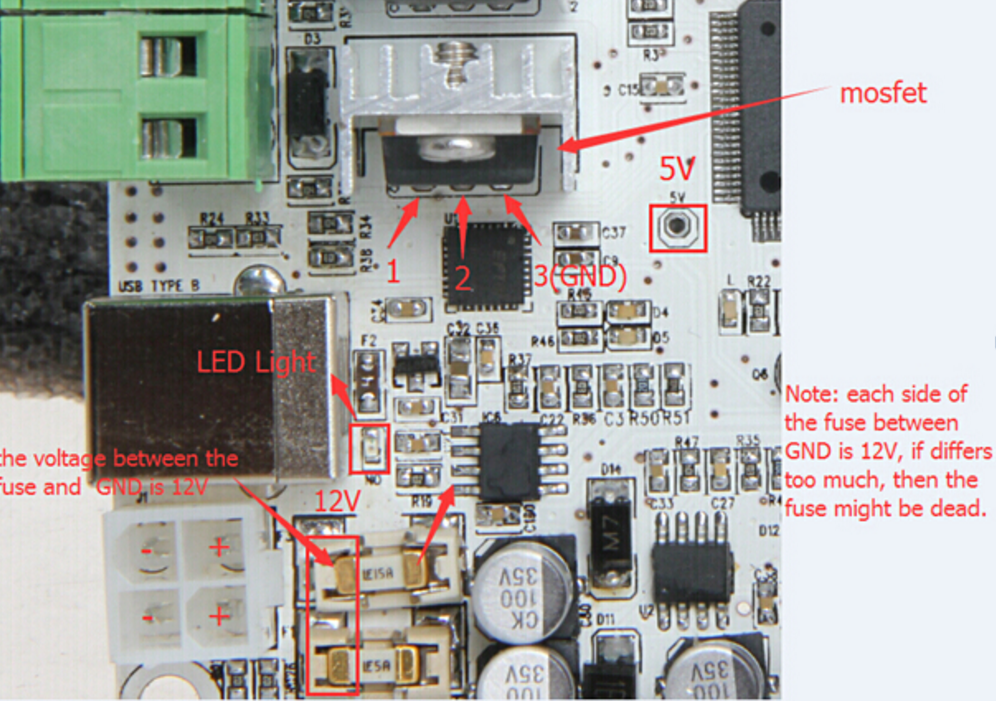

Hi,here is the position of 5V and GND.

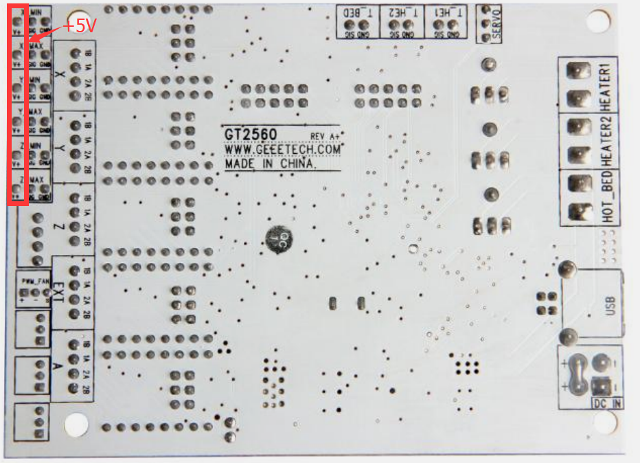

You can use the rest endstop pin of the board.There are actually 3 pins on the postition of endstop connector .Remove one of the connector from the board and replace it with a 3pin straight Pin.You need to use soldering iron here.Then you can use the +5V pin.
