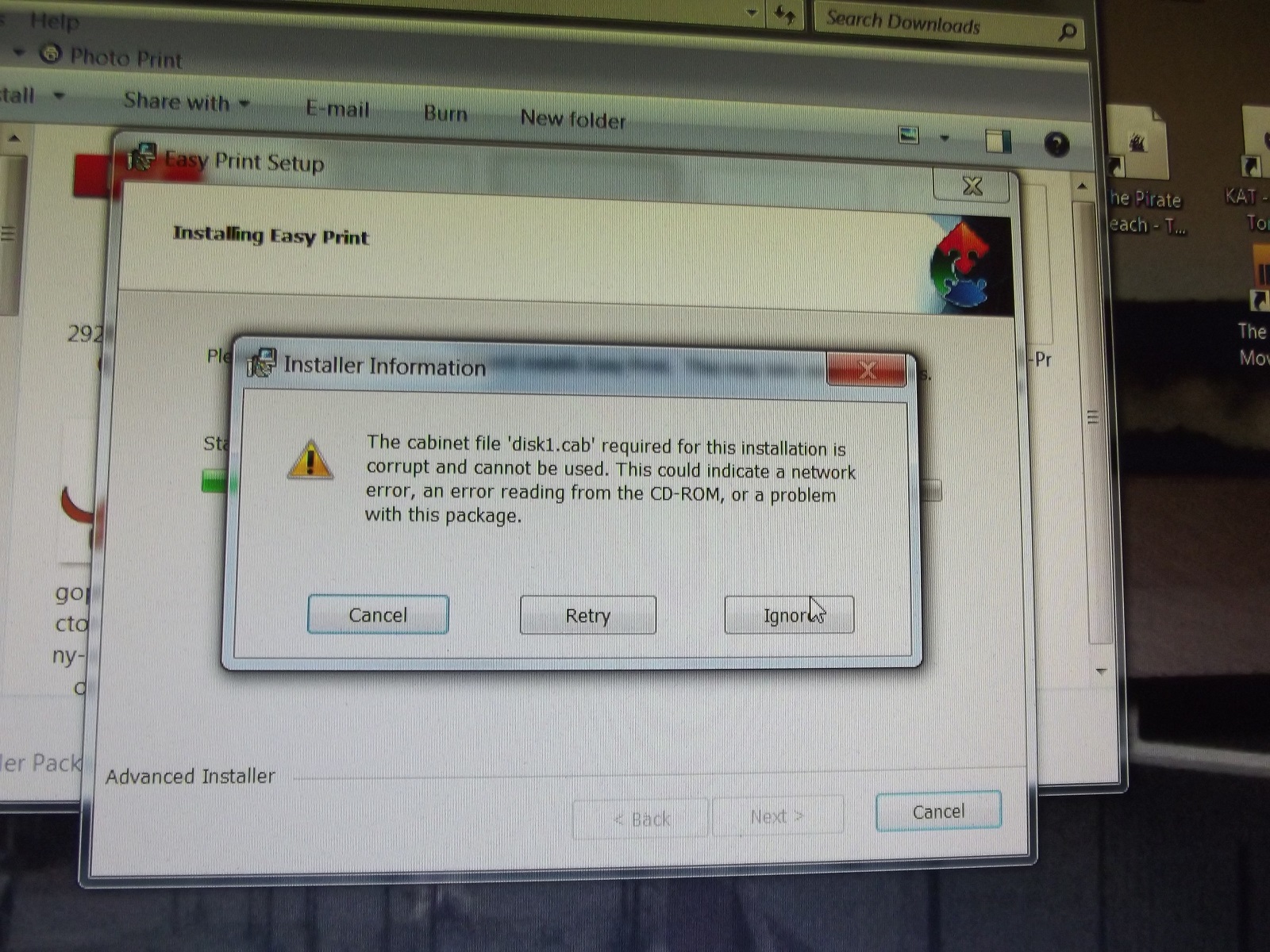

OK I did finally managed to download Easyprint.
But when I tried to install it I got this message ( The Cabinet file 'Disk1.cab ' required for this installation is corrupt and can not be used)
So what is next ?
Re: printer not working after changing circuit board
Posted: Tue Jun 06, 2017 10:34 am
by William
Which operational system are you using?It will be more stable in Win7.BTW,please show some pictures about the error.
Posted: Tue Jun 06, 2017 10:43 am
by nutts
I am using windows 7
Posted: Tue Jun 06, 2017 11:23 am
by nutts
I hope this a picture of Eastprint Error
