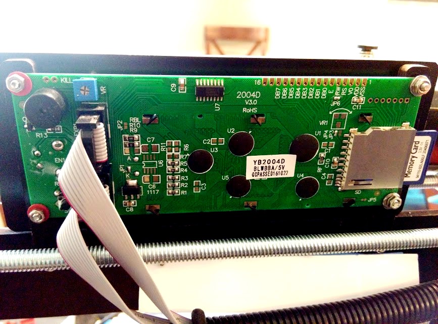

What should I do with an echo:SD init fail error.
My board is hanging on echo:SD init fail and the LED will not power on. I'm using a GT2560 A+ board and made the following changes.
SERVO0_PIN from 32 to 11 in pins_GT2560.h
comment out the following three values in Configuration.h:
#define BLTOUCH
#define AUTO_BED_LEVELING_BILINEAR
#define Z_SAFE_HOMING
Here's a photo of the LCD/SD card board.
