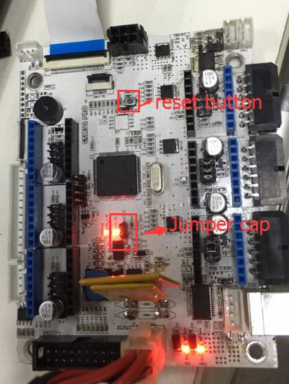

2.2 Insert one corresponding jumper cap on the boot0 of the board.
2.3 Connect the USB cable.
2.4 Press the RESET button.

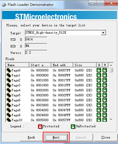

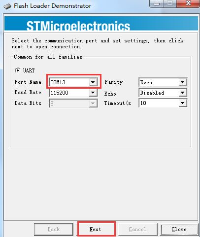

2.5 Open the Flash Loader Demo, confirm the COM port, for the rest do the setting as default. Click the Next.

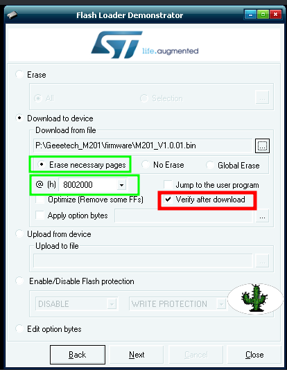

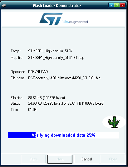

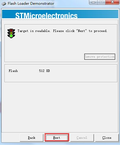

2.6 Choose the firmware you want to burn and check the "Erase necessary pag" radio and the address "8002000" and click Next to install it.
(Don't forget to select "Verify after download")
GTM32 VB UPDATA.png (29.16 KiB) Viewed 65504 times

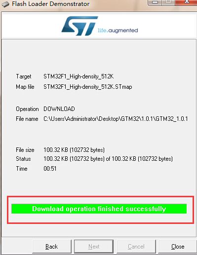

2.7 It means the burning is successful if you see the words of "download operation finished successfully!".
GTM32 VB UPDATA2.png (25.55 KiB) Viewed 65504 times
