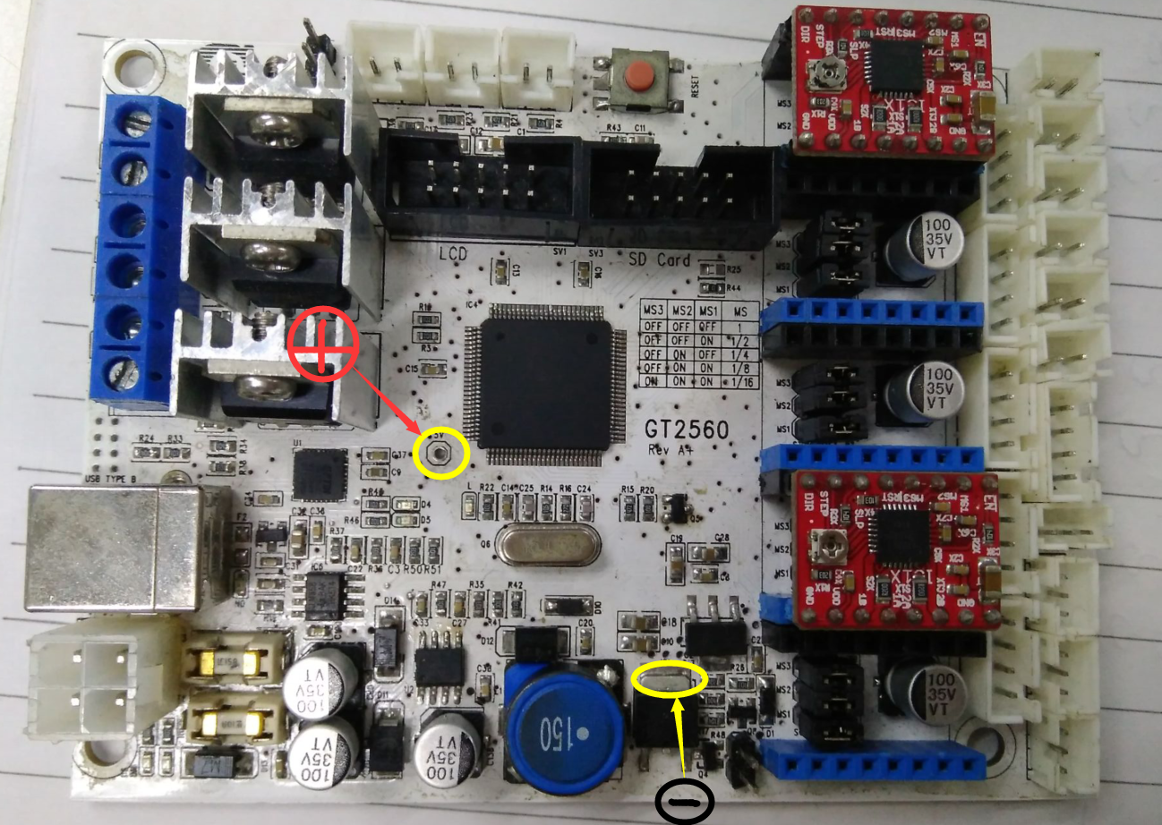

You can check the voltage of here. Normal is 5V

Checked that with a volt meter. 0.0

Don't know if the first post went through, but getting 0.0 volts from there.
