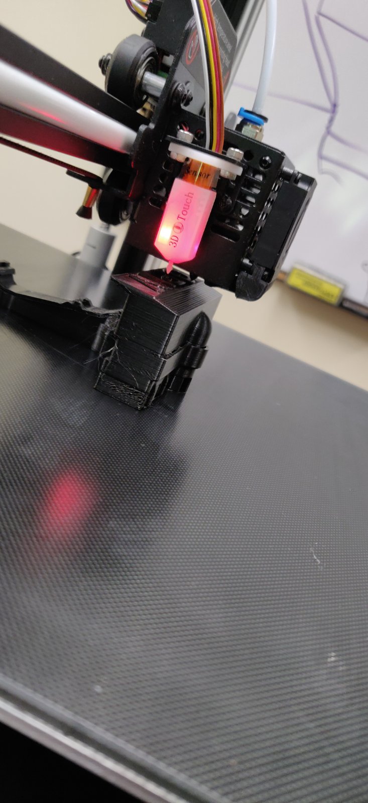

I recently build my I3 Or and noticed something
My Prints come out slanted on the Y Axis
Any Idea?
Here is a Picture
https://www.dropbox.com/s/5zaqnype7wioa ... 5.jpg?dl=0

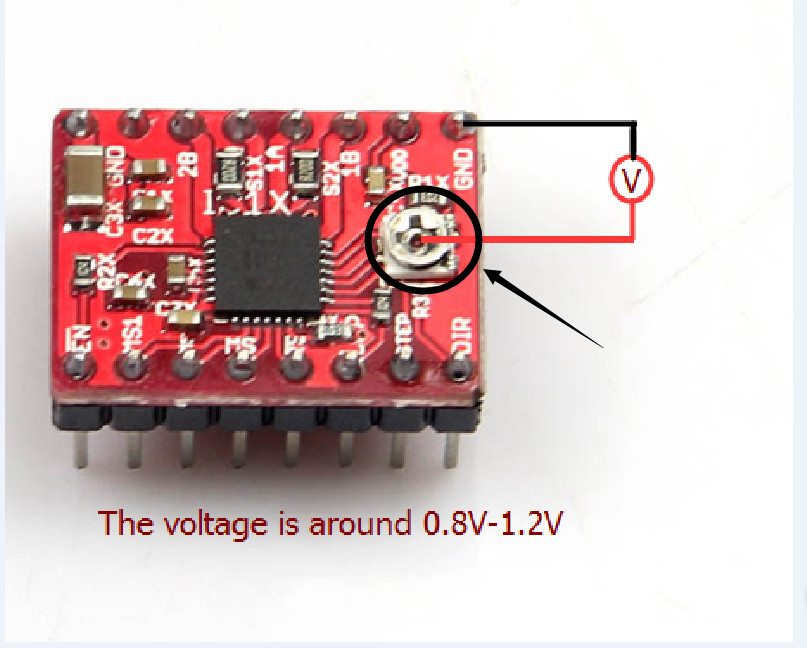

1.Check the belt of Y axis
2.Increase the voltage of Y-axis driver board A4988
3.Adjust the tight of Y-axis screw
Y motor.png (839.18 KiB) Viewed 23591 times

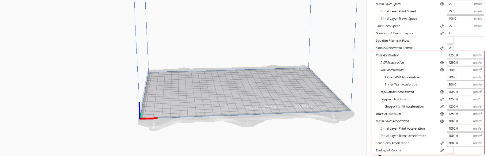

Adjusting Acceleration, Jerk and Steps fixed it.

How did you adjust those parameters?

Yeah seriously, how did you adjust those settings? I can see them on the screen but I haven't figured out how to change them at all.

If you are using Cura you are able to change those settings directly in the slicer! Think cura is the only slicer atm that support that feature.
Otherwise you have to change those settings in your firmware.
