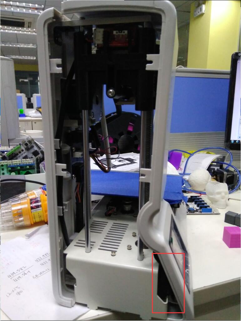

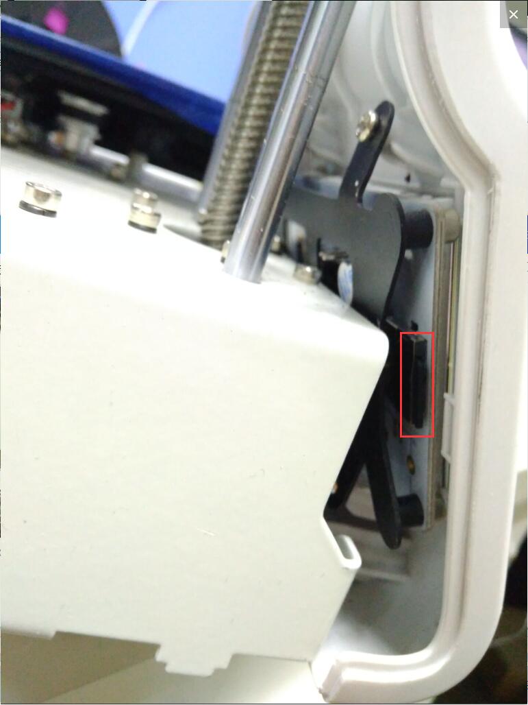

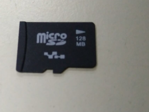

Guide
1.You should open the side protection cover
2.You should take off the sd card
3.Format the SD card
4.Copy the un-zip files to root directory of the sd card

Do you have step by step instruction how to open side cover without damage printer?
I need to remove some screws.
