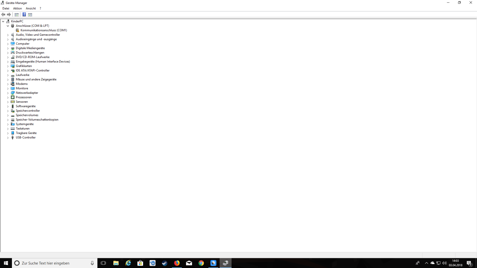

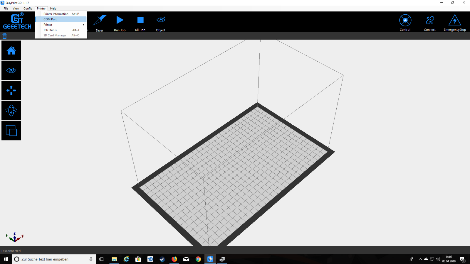

I had Installed Manually the Driver and Easy Print 3D, but when i go in to Easy print 3D, i can't choose a Com Port.
I can't see the Port in the Device Manager.

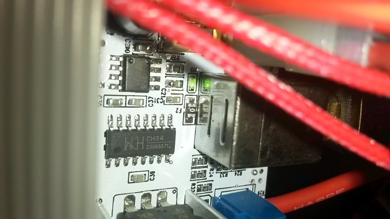

[attachment=0]20180403_141642[1].jpg[/attachment]

- I had Downloaded Ch340_EXE for this chip.
- 20180403_141642[1].jpg (287.35 KiB) Viewed 26224 times
- Still I can't choose a Com Port
- Screenshot (2).png (170.64 KiB) Viewed 26224 times
- My Device Manager
- Screenshot (1).png (96.92 KiB) Viewed 26224 times

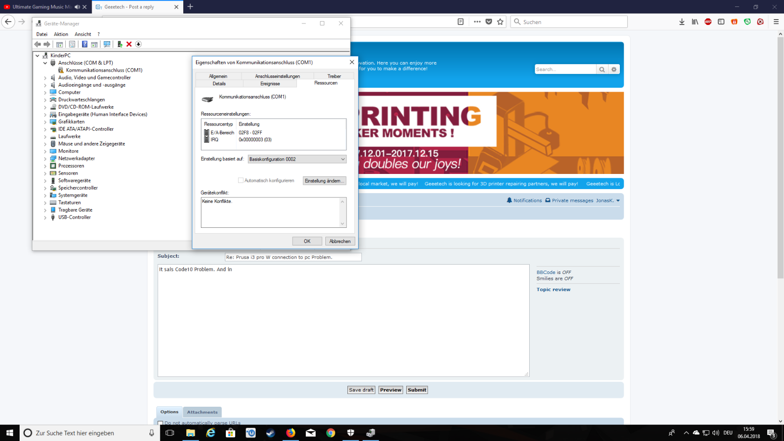

Re: Prusa i3 pro W connection to pc Problem.
It sais Code10 Problem. And in Ressoucen is only one thing changeable.
- Screenshot (5).png (279.84 KiB) Viewed 26079 times
