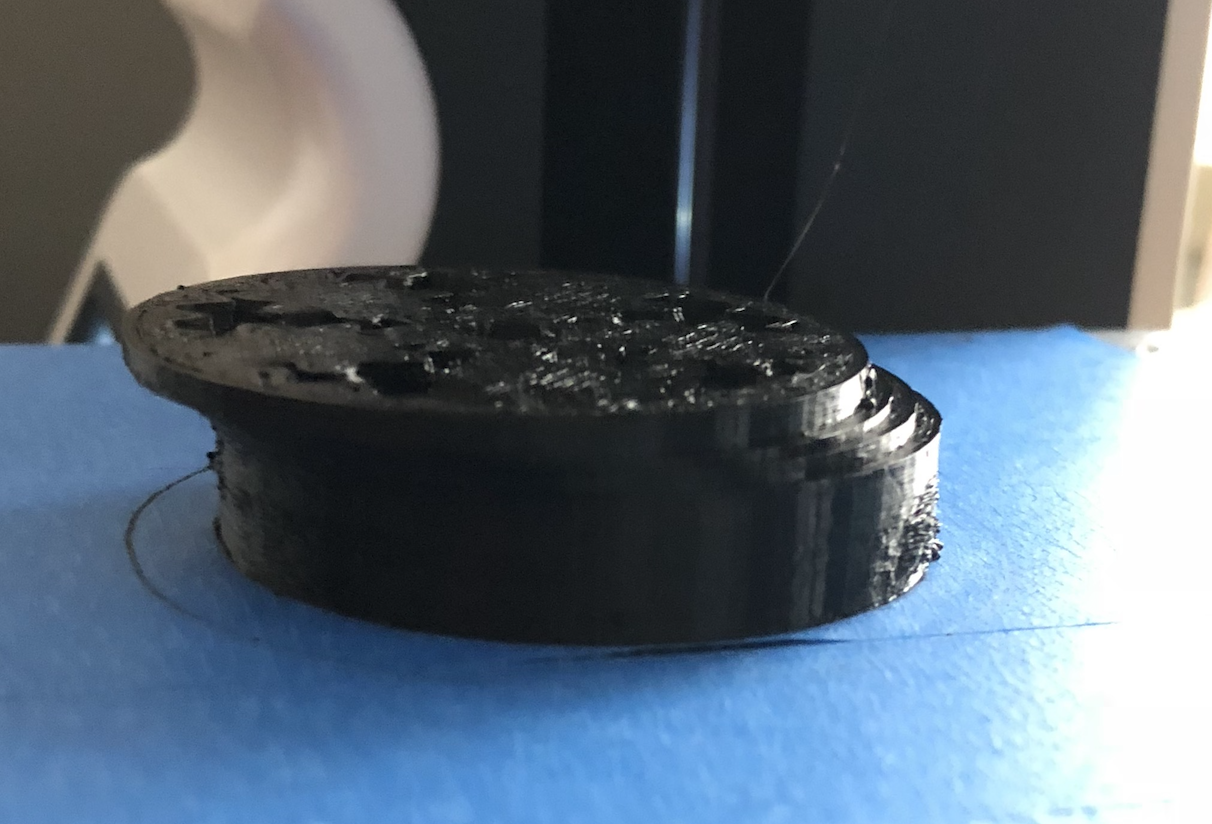

I have the same Problem!
I printed from SD-Card over night, and in the morning I realized it shifted the Layers a bit.
I have Firmware-Version V1.29.36 (the newest one)
Bildschirmfoto 2018-06-17 um 17.21.29.png (1.39 MiB) Viewed 15339 times
Is there any solution or workaround yet?
Thanks
