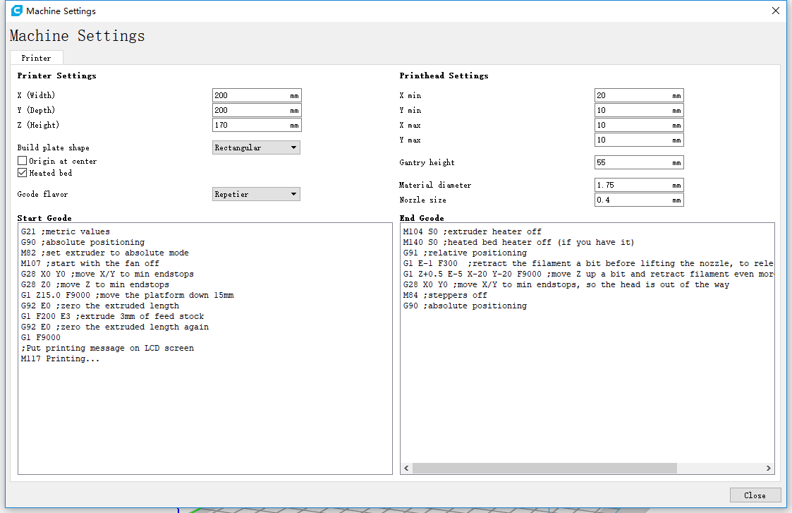

Here are my cura profiles for I3 PROB(Not perfect always,welcome to anyone improve it)
I3 A.png (56.24 KiB) Viewed 28256 times
Refer to it
