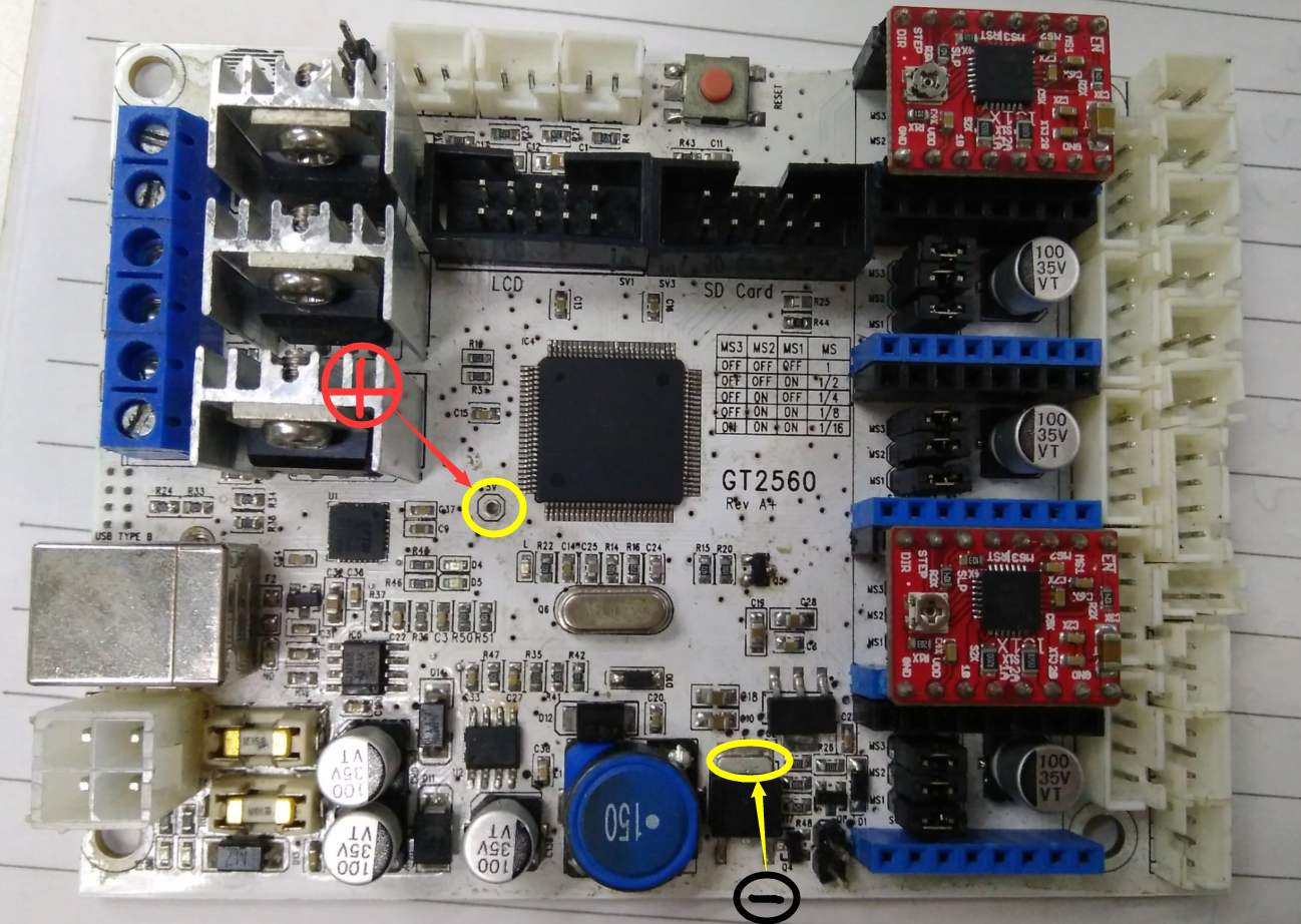

Try to refer to this pic then check it.
Normal is 5V

Thank you, Thank you and thank you again, I now have a starting point. I did indeed checked the voltage and it reads 2.0 VDC. No USB connection to the printer during test and 4.36 VDC. It would be nice if an electrical schematic exists for this board. Can you suggest the next step. I fear that the problem is the main board itself. Why it happened is any ones guess. Has this happen to others? Is there any guarantee with this board? I did have steeping problems at the start a couple of times and a rapid X,Y shift to its next point but didn't quite make it. I kept all the failed prints if need to be viewed. For awhile it ran much better after some tweaking until this happened. Now it is totally useless unless this can be resolved. Again thanks for your help.
