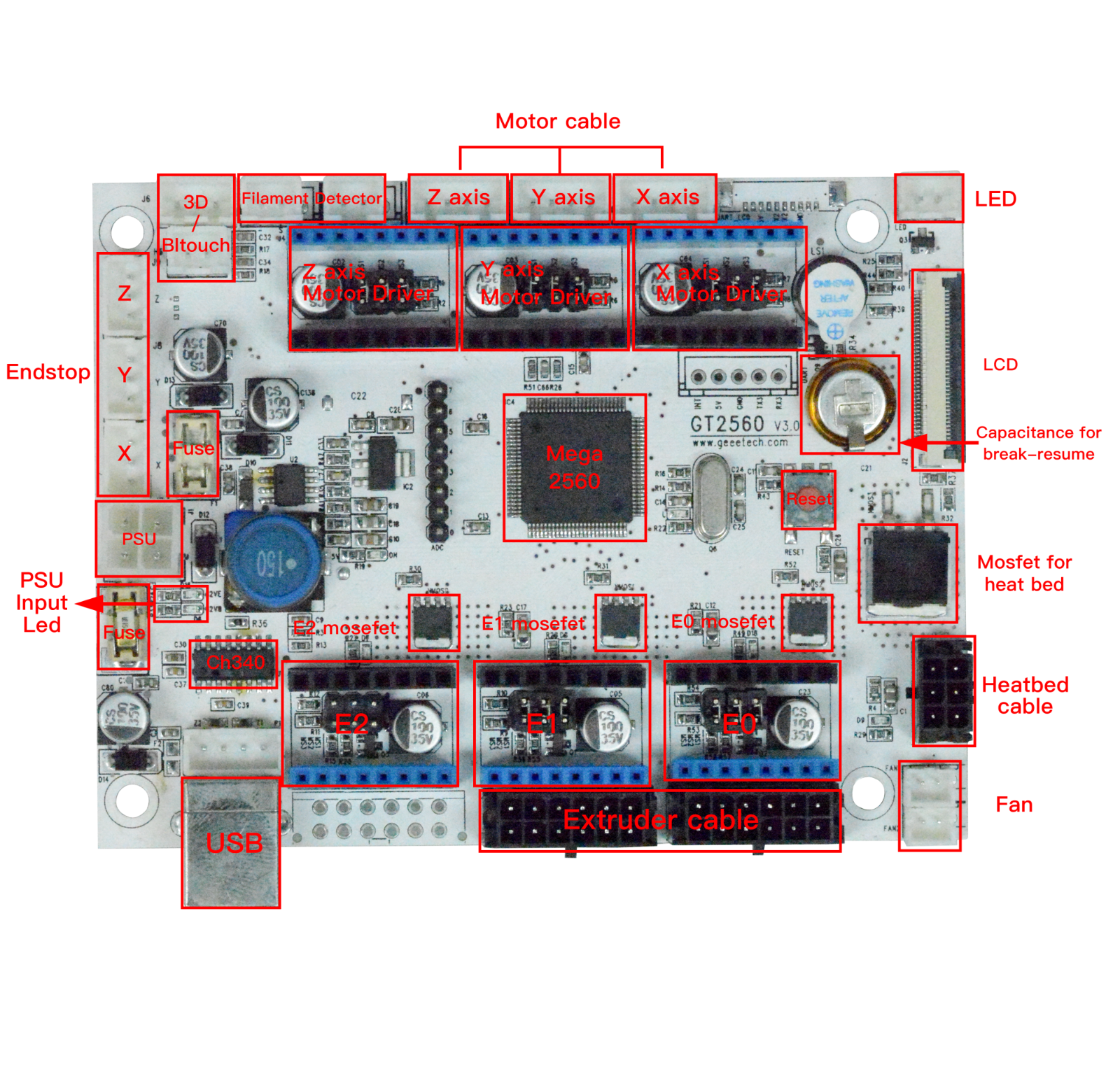

Refer to the attached photo
GT2560V3 wires.png (2.69 MiB) Viewed 22941 times
