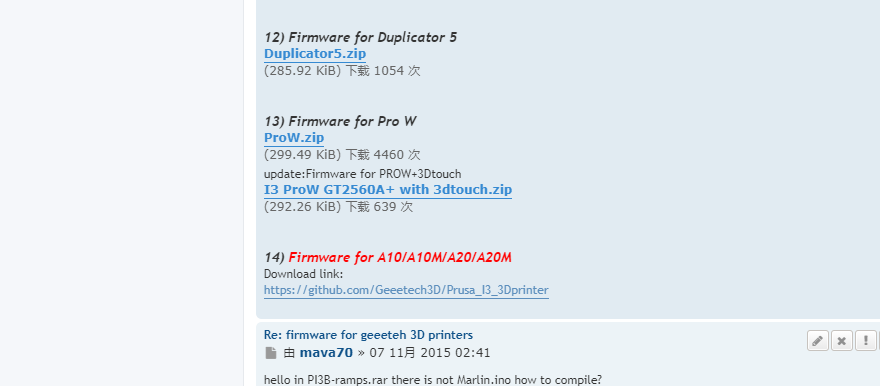

I have the same problem,(I3 ProW GT2560A+ with 3dtouch.zip) your firmware does not work for 3dtouch or BLTouch (I have them both), you can solve it please.
question:
I have to give this command (Check the threaded rod of your printer(Especially I3 PRO X, I3 PRO W, I3 PRO B, I3 PRO C)
If your printer working with T8 threaded rody ou need to send Gcode"M92 Z400" via USB port.(When you upload the firmware finished)
Then you need to send Gcode"M500" to save the setting.
also with the firmware I3 ProW GT2560A+ with 3dtouch.zip?
thank you.
