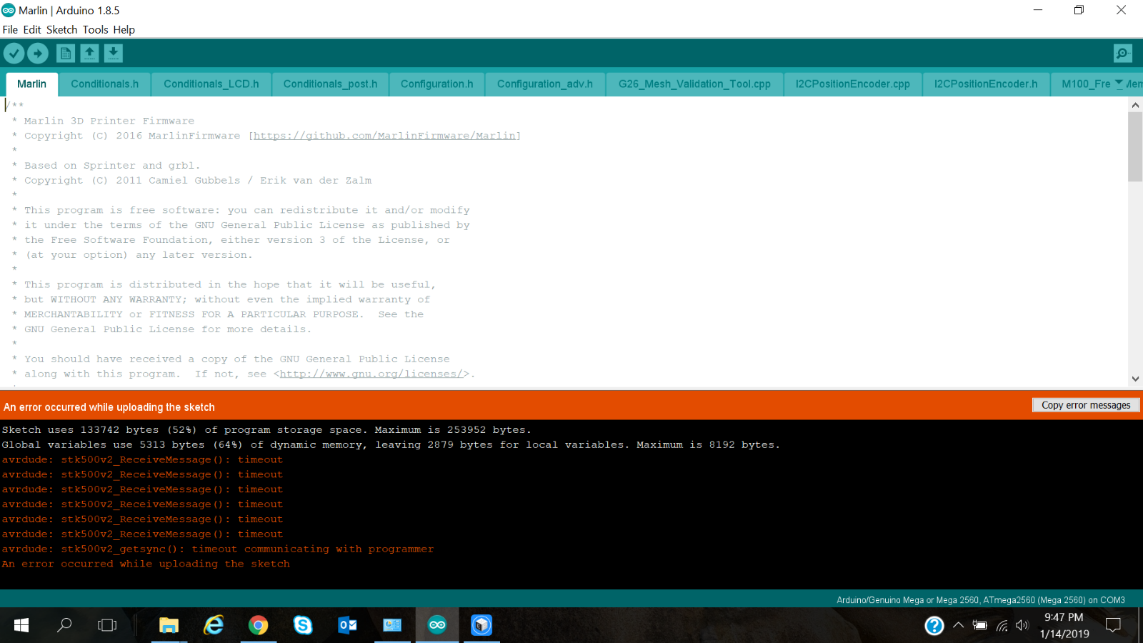

My lines went away while I was trying to re-flash. My printer started working again for several days until yesterday when I turned the printer on to the 2 lines again. I've tried to re-flash the A10M's 1.1.8 version with Arduino 1.8.5 and connected with COM 3 with the CH341 USB COM driver but always get a timeout error. Thoughts on what I'm doing wrong?
