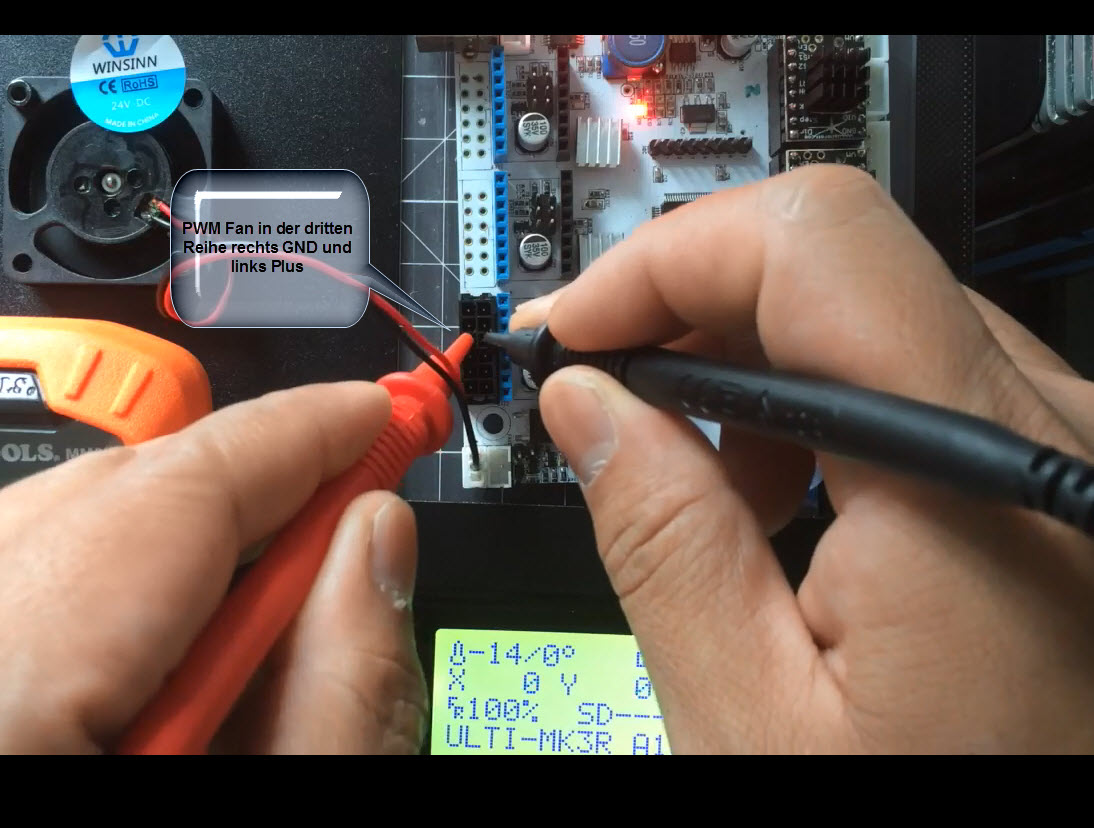

i found in an video were the PWM outputs might be. I upload a screenshot from this video. I have to try it out first at home.
Its on the connector which comes from the hotend. It shows the old rev B which might pin compatible with Rev 3!
There is no jumper on my board, this place is empty.
I have somewhere here in the forum read that the connector board near the hotend might be the problem, maybe there are bridges on the board -> i have to check @home first.

Be aware about the screenshot you posted above. GND in the picture is wrong, it is the output of a MOSFET (for example Q2) and depending on the PWM signal it can become a voltage like GND. The "Plus" is VCC (24V) all the time. When the PWM signal is off the MOSFET output will follow VCC, so there is nearly no voltage drop over the fan, fan is off. When PWM is on and the value goes up to 255 (=100%), the MOSFETs restistance will become smaller and smaller, all voltage will drop over the fan =on.

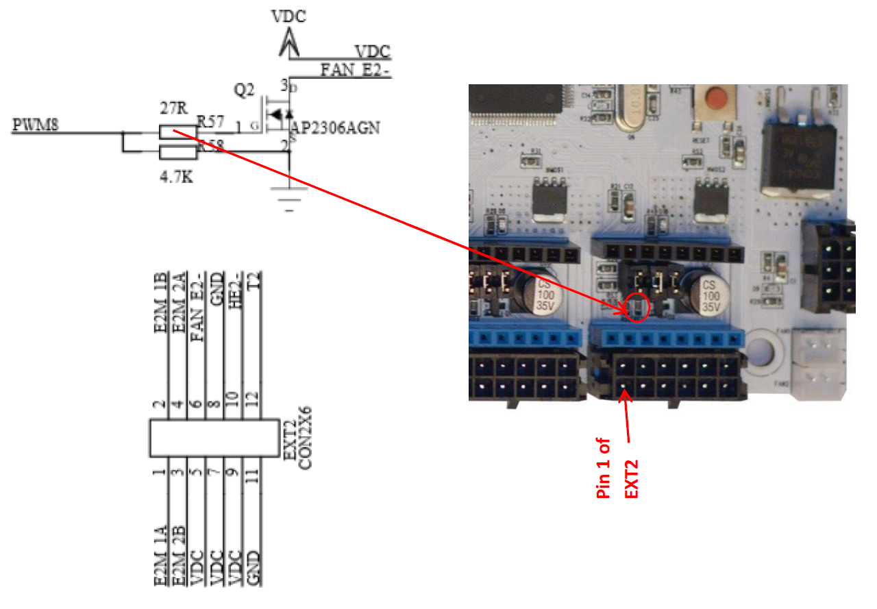

Try to measure after the picture i made (see attachment).
1.Disconnect the extruder cable. You can also disconnect the little red pcb with motor driver (like on the picture). Turn on the GT2560 and measure from Pin 9 to 6 of EXT2 (Do NOT take 5 instead of 9 because its more dangerous there to do a short and detroy the board :) ). Vary the PWM signal in the printer menu, the voltage should drop from 0-24V. If it does not go on with step 2 otherwise go to step 3.
2. Try to measure the PWM signal coming from the microcontroller: Measure from GND (Pin 11 of EXT2) to one side of the resistor R57. It is marked in the picture and difficult to reach(!). Here the voltage should drop from 0-5V (or 0-3V, i´m not sure at the moment) with varying the PWM signal. If it does not the microcontroller must be defective => get a new board :( . If it does the MOSFET Q2 must be defective=>change it. Double check the MOSFET: Turn off the GT2560 and measure from GND (Pin 11) to to Pin 6, if its shorted the MOSFET can(!) be defective. With your first MOSFET measurement you proved it :-).
3. Go back to my first answer above "...everything is fine on the board and the problem must be in the cabling or the small pcb at the hot end/extruder ...."
