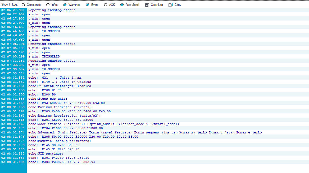

I did the M119 test on the endstops and they report they are being triggered. I am at a loss.

Thanks for your reply, Wires and connecters seem fine. As I say the Homing works fine, the endstops work up until it goes to start printing. I will make a video tomorrow showing what it does. I have re uploaded marlin just incase it was currupted but still happens. Also if I use G1 F60 Z0 command To goto true Z 0 the printhead moves very slowly to the Left along the X axis.
