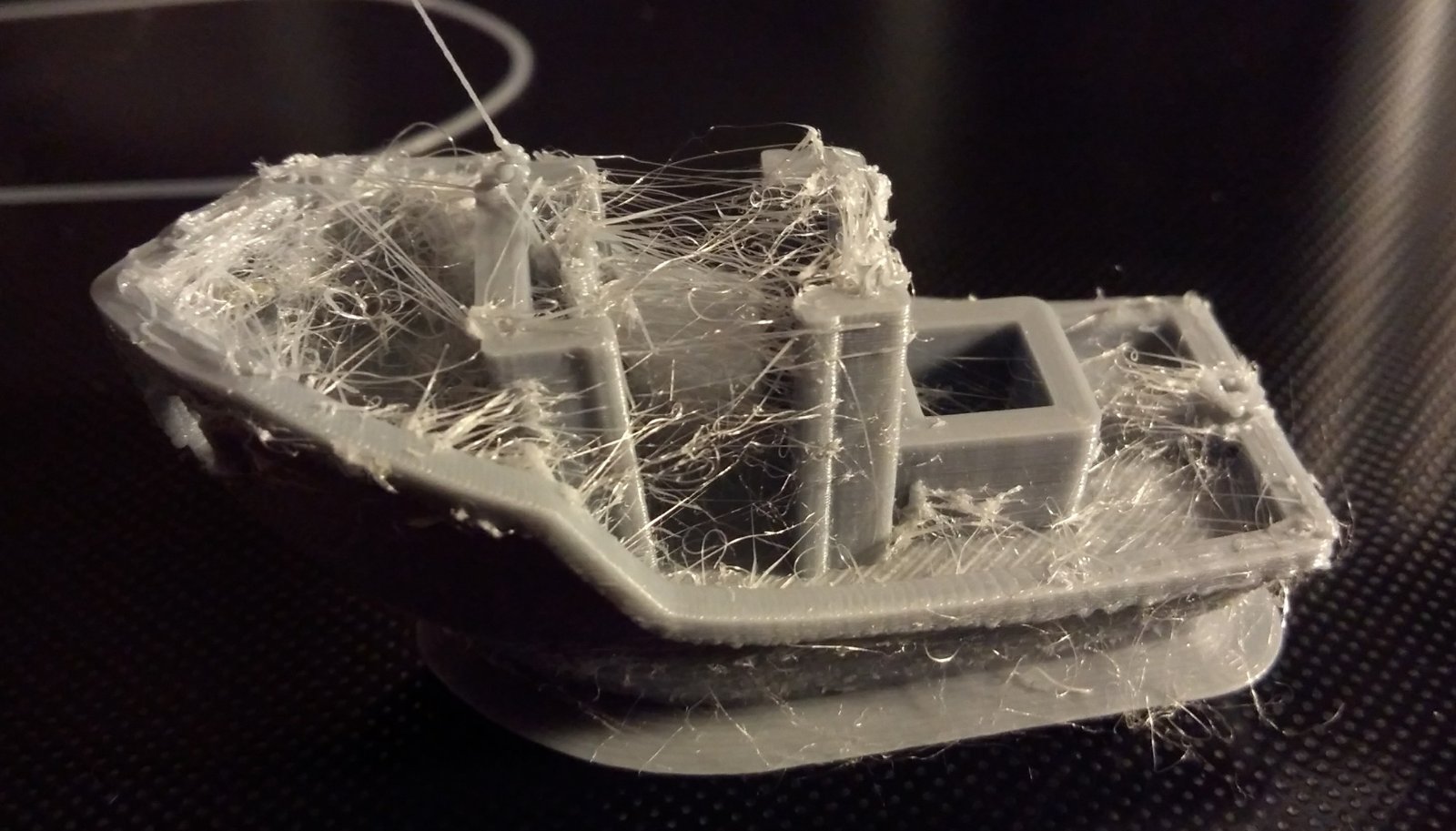

Hello all,
I have still massive problems with stringing:
I reduced / increased retraction, no success. I modified temperature, E-Steps/mm, Filament, ...
Now, the next I will try is to increase the print speed and to use Cura to enable Coasting, which isn't supported by Slic3r.
Any ideas?
Or, can somebody provide an gcode of the Benchy or any other sample which works well on his A20m?
Thanks,
Moritz

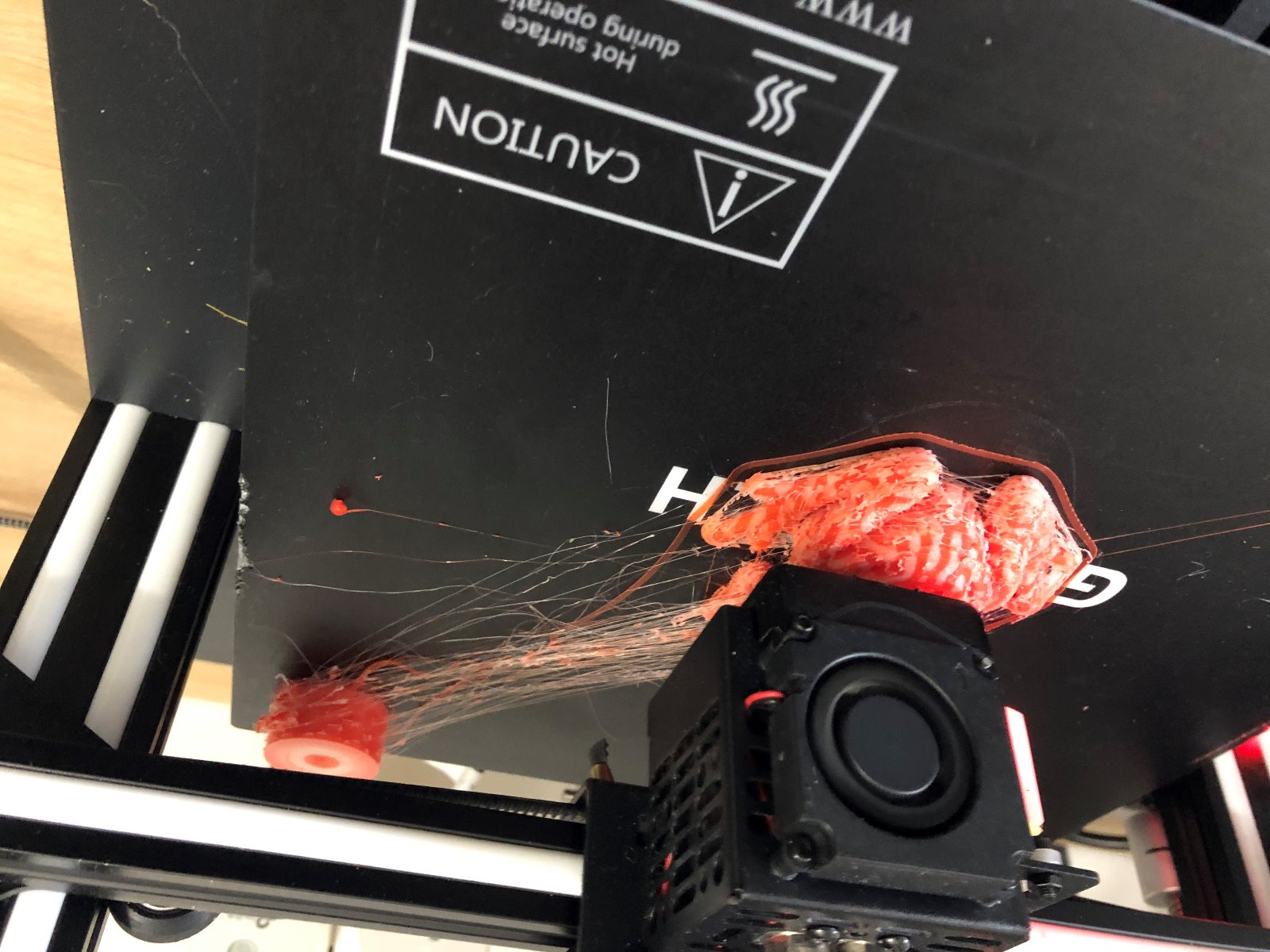

Re: Still massive stringing problems with my A20m
Posted: Fri May 03, 2019 1:15 pm
by BR365
Hello Vert,
very interesting, you mean these small balls?
It looks like a kind of back pressure valve to prevent, that the filament is pressed from one filament feed to the other one. But, then it is very clear, why retracting doesn't work so effectively like with single hot ends.
That means, that there is a technical reason, why a color mixing hot end will create more stringing then a single hot end.
Where is the picture from? Is there a discussion about this issue anywhere?
Thanks,
Moritz

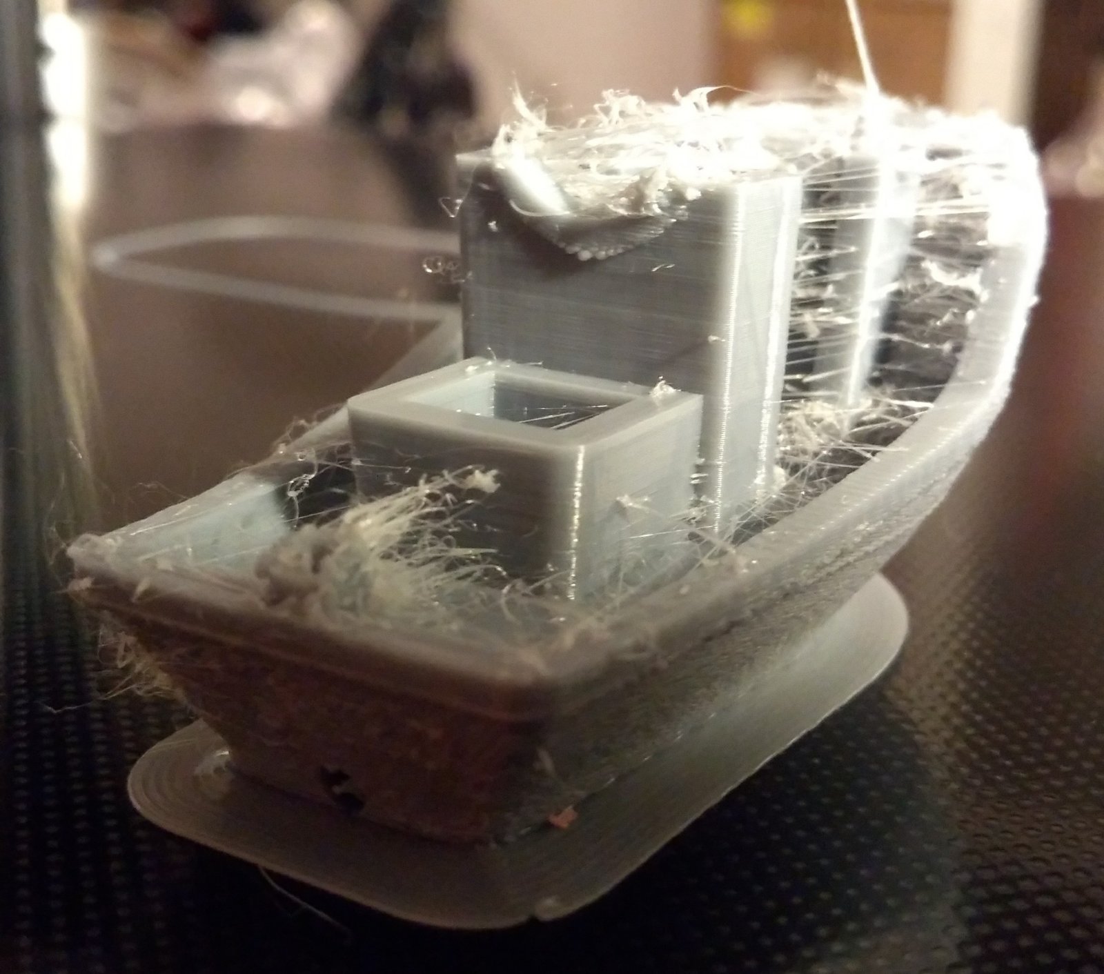

Posted: Wed Oct 30, 2019 5:26 pm
by dtouton
I have removed the two balls and still have big stringing problems.
I have tried all distance and speed of retraction.
Have someone found the good settings ?
Thanks

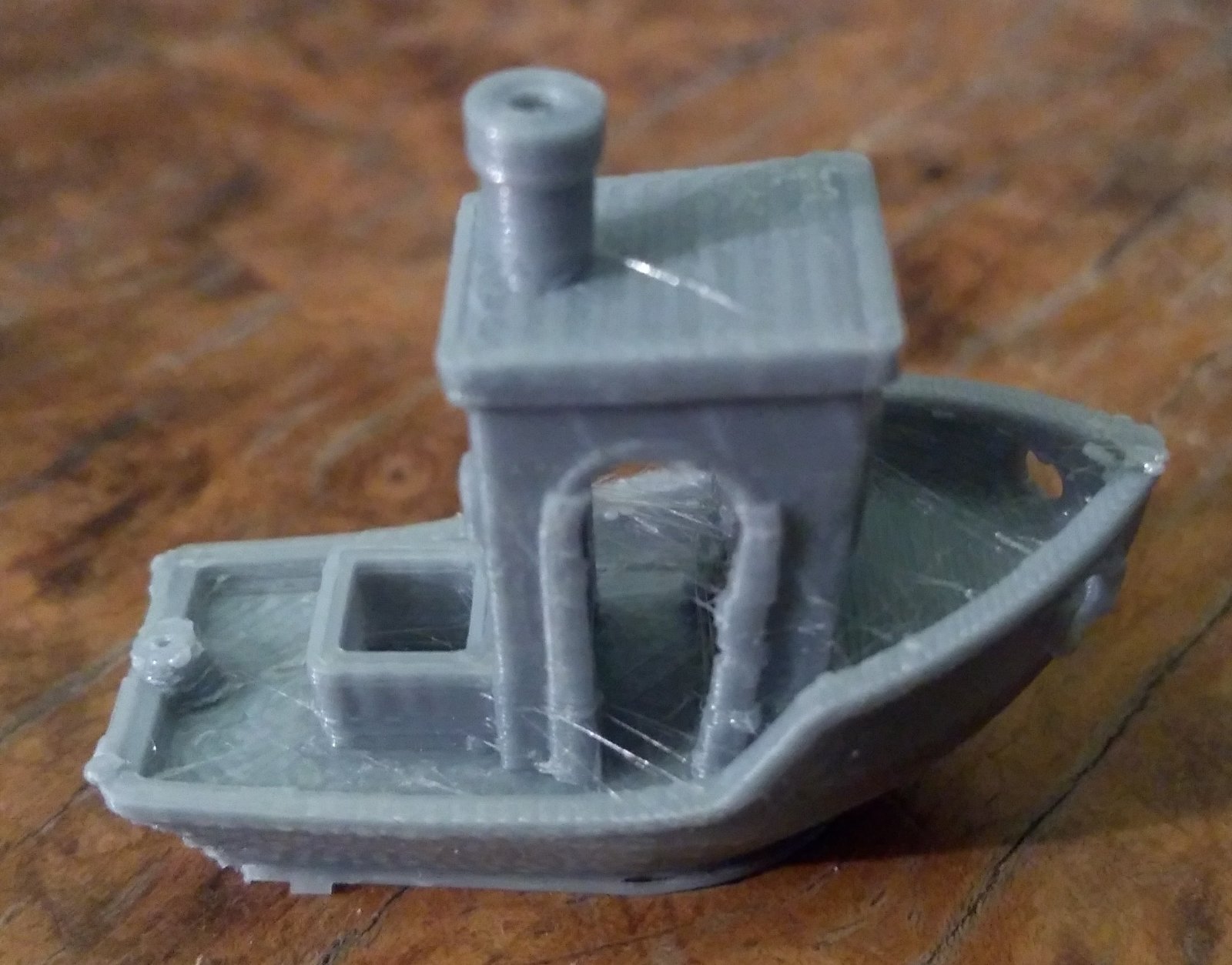

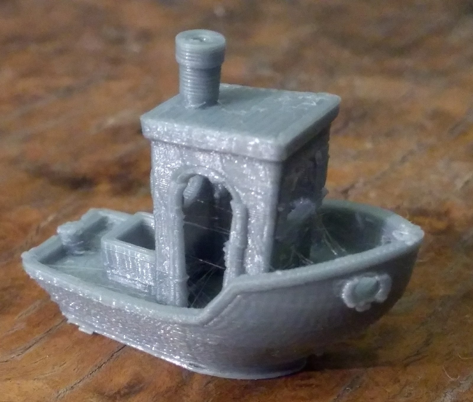

That is what I call massive stringing ! :D
Here is a picture of a benchy printed with A20m stock with valve probably, dont know(only stepper drivers of X,Y,Z have been replaced by TMC2208 but I am sure that can not modify stringing), I try to join the gcode but I can only attach picture to the post..., I will try by PM.
Settings I remember : (but that shouldn't help a lot, you probably have a mechanical issue)
- layer height : 0.2
- print width : 0.4
- perimeters : 3
- main speed 50mm/s
- outline speed 37.5mm/s
- retractation 5mm at 30mm/s
Some ideas :
- wet filament ? https://www.youtube.com/watch?v=FAXUjZZER5E
- too fast retraction or extruder untight , that could make the filament slip when retracting
- temperature too hot
- cooling fan breaked
NB: stringing is not the only problem you have, some of your surfaces show a lot of rugosity

Posted: Tue Nov 05, 2019 1:38 pm
by 3DAngel
may I know what slicer are you using?
and what travel speed you have set.
what was your Max acceleration set in the FW.....
I have the back flow disc removed, but still fighting the stringing.
are you using linear advance, traditional Jerk....
too many variant to play with..
I have set 200mm/s travel speed
8.5mm retraction
30mm/s retraction speed
1.75mm coasting
linear advance disabled.
using S3D V3.11 or Slic3r Prusa results are similar
PLA temp @185C bed 60C
appreciate any feedback
thanks

I removed the balls, tried all i can do on Cura. Single color prints are really nice, better than my ED3 Pro, but Dual Color look like tihs :o
Posted: Tue Nov 05, 2019 5:59 pm
by William
Hi,You can refer to:
Retraction speed: 40-50mm/s;
retraction distance: 3-4
Posted: Tue Nov 05, 2019 6:02 pm
by dtouton
This print :
distance : 4
Speed : 40
I think i will try to re-install the balls
