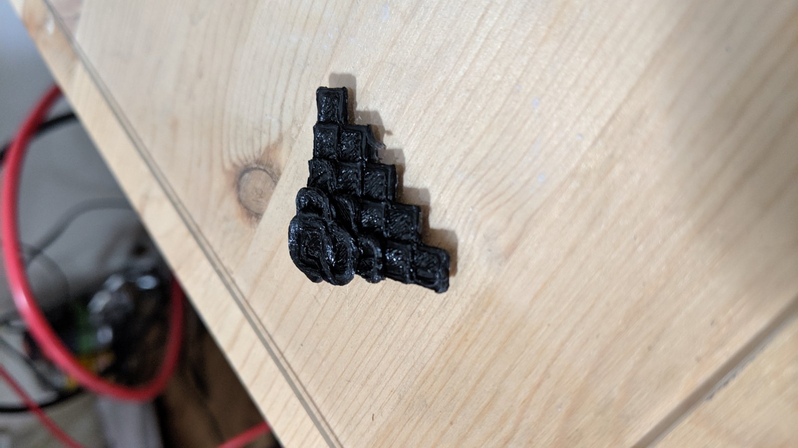

I'm going threw a MESS of a build, I updated to Marlin 1.1.8 and I had a steps problem. I compared it to the 1.0.2 firmware that was on it and made some edits so that things matched.
They don't..
My print now looks like this:
The board is an A+ board so the 1.1.8 firmware should be good for it.
What am I missing?
Re: Z Axis Steps problem...
Hi, from the picture, you may need to adjust the distance between the hotbed and the nozzle.

Turns out the steps was the problem. rather then the 2560 it should have been... it was only 50...
