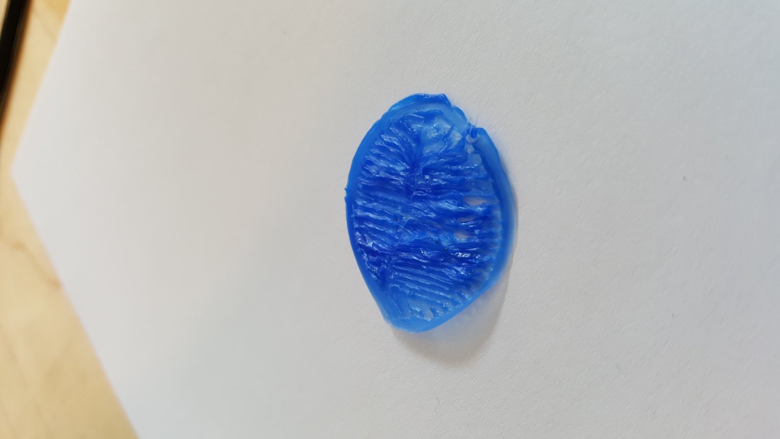

I've calibrated my extruder (and z-axis), now it's working but the result is bad - see pic.
Additional to this, the z-axis (tries) to move fast while auto homing and is blocking thereby.
I've got already reduced the z-axis speed, but this isn't working while auto homing.
Who can help?
Re: To little filament while auto printing
Hi, Are you referring to your z-axis not moving properly?
If you can't move normally, you can check the following points:
1. Check if the threaded rod of the z-axis is bent or lacks thread if it needs to be replaced;
2. Check if the brass nut is installed too tightly and loosen it properly.
