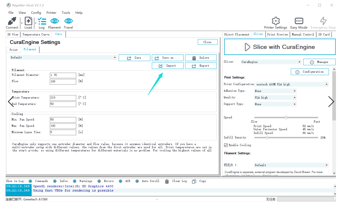

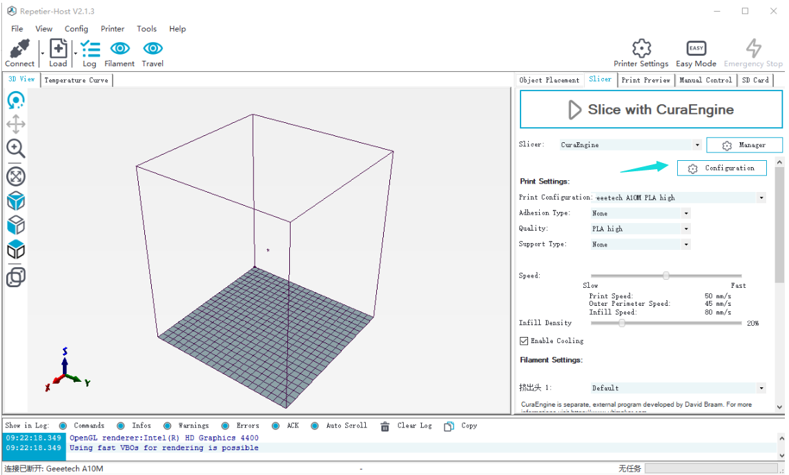

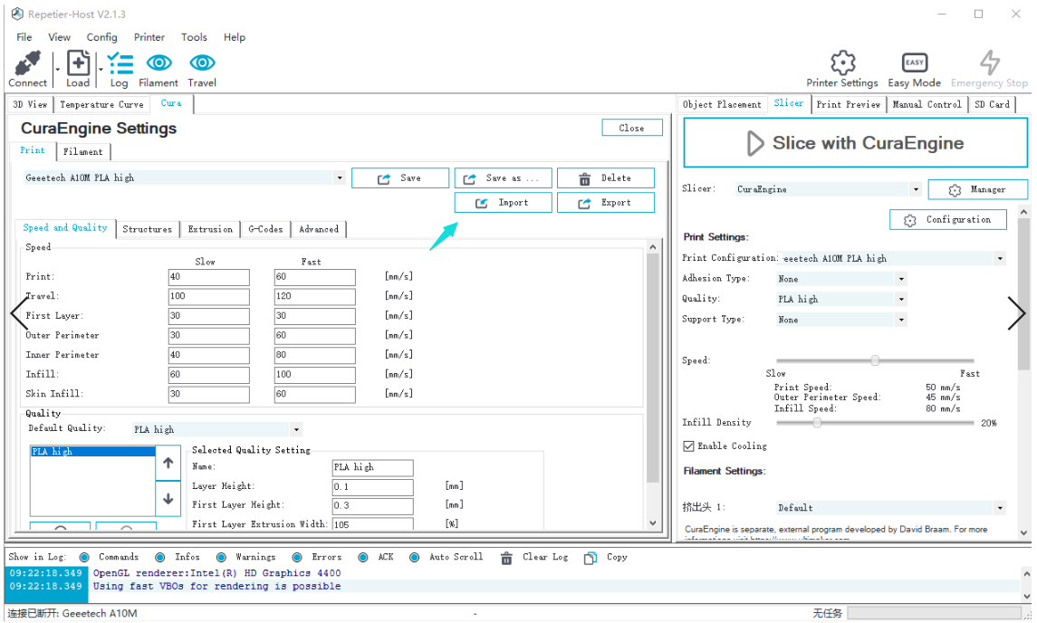

Re: Driver Settings for A10M with easyprint3d
You need the following:
First set the parameters of the printer,
Secondly, connect the printer;
Then disconnect and select the configuration on the right side of the slicing software; Select Print-import-select A10M PLA high .rcp to import and save; In the material -import-select A10M PLA high fi.rcp to import and save, complete the configuration.
