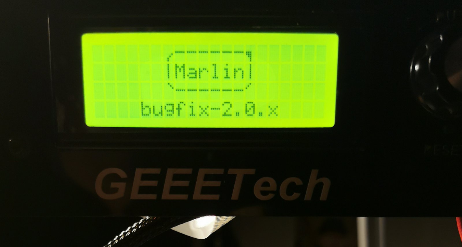

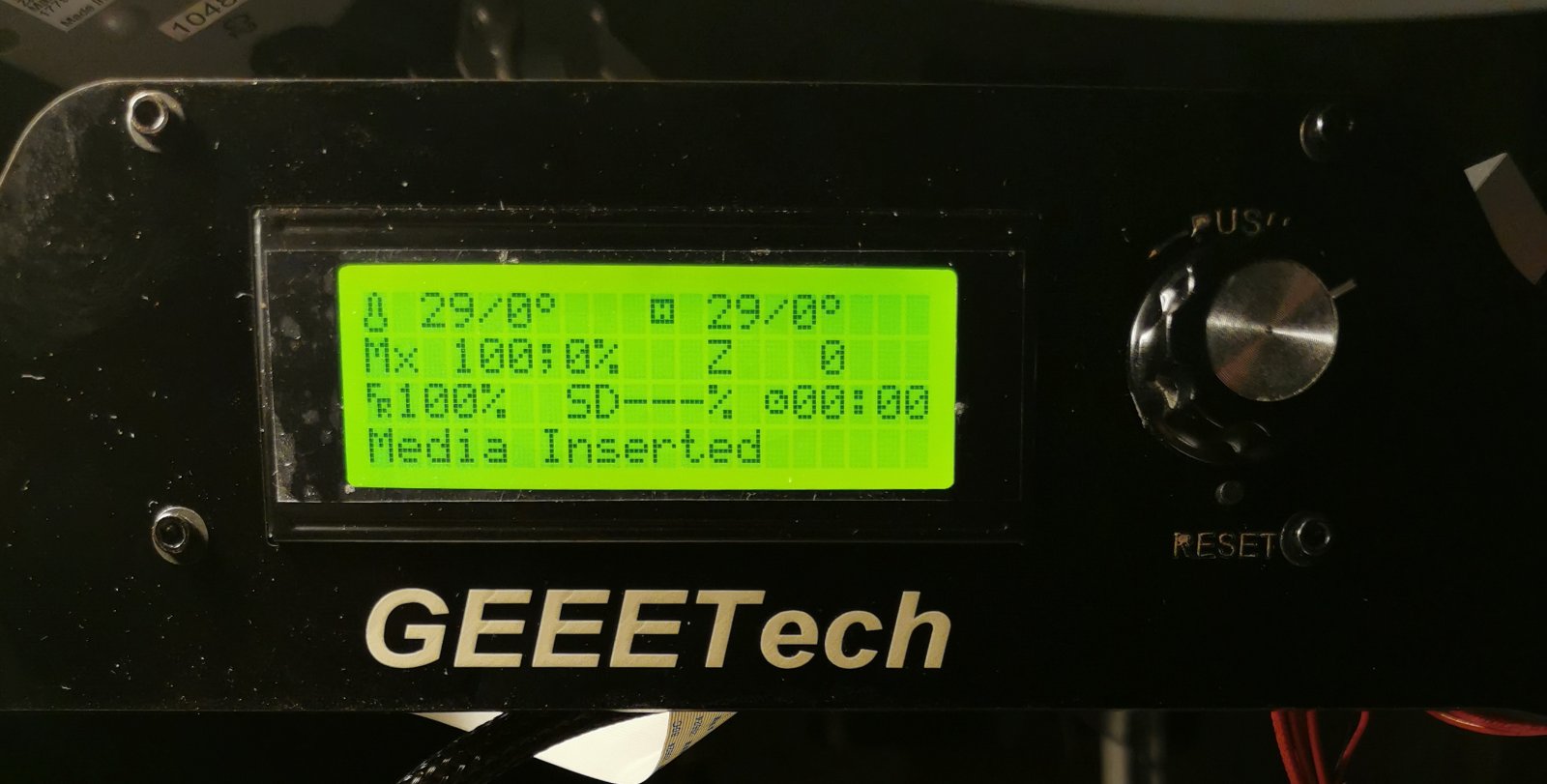

UPDATE : Pending issues SOLVED
-> SD Card reader on LCD WORKING (replace pins_GTM32xxx file by updated one available on the google drive)
-> Mixer WORKING (but sure to apply u8glib library update as described below)
I wish to really thanks InnerBushman and Vertabreak who thanks to their contribution on Github give me the ability to stick all the element together

13. (uups hopping to be lucky). Load in Arduino the Marlin.ino and click the "checkmark" icon or menu Sketch/Verify-Compile
Compilation should give you two white line with "Sketch use...."

22. Press next and wait for the upload to be completed. When finished, your screen will display the Marlin 2.0 logo and be ready to operate (almost... don't forget to remove the 15 jumper.
