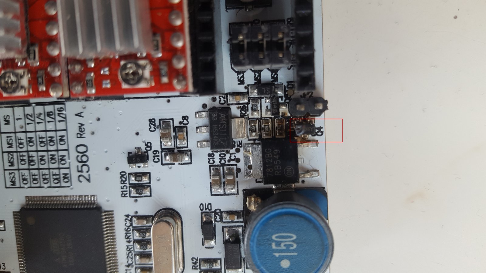

Hello, I have problem with burned transistor it is marked A9KV 18 - I can't find any specification. Could you help me to find it?
- a1.jpg (185.42 KiB) Viewed 3910 times
Re: 2560 rev a Transistor Burned
Hi,if you are referring to a crystal oscillator, it is DIP 49S, 16MHz, 20pf, 10ppm.

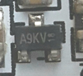

No this isn't what I'm looking for. Here's a photo it's the second on the same board.
- 20191014_121951.jpg (91.12 KiB) Viewed 3906 times

Hi, for the principle you can refer to this: https://www.geeetech.com/download.html?download_id=43
This is AP2305AGN
If you have a short circuit twice, causing problems with the motherboard,
I suggest you check it out.
This is AP2305AGN
