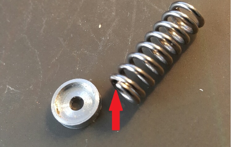

I now start to get close to getting a nice level bed but from one day to the next it goes out of wack. Along this journey I discovered the original springs on the bed were going soft so I replaced with what I could buy locally. I then discovered that it is these springs that is causing my changing bed level issue. The end of the spring isn't tapered so each end of the spring has a dip where there would normally be a tapered end to the spring. A photo helps explain this.
The red arrow shows the dip and sharp end I'm talking about. This isn't a problem on the lower side against the acrylic base as there is a nice wide flat surface but the under side of the bed heater has rounded corners and the bolt hole is very close tothe edge which in fact the spring was able to drop off and when that happens it changes the level dramatically.

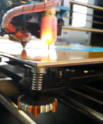

The solution was to make a seating washer for the top of the spring and BINGO we are level again!. I installed a 3DTouch in this journey and now I've got all these issues sorted after manual level then calibration I watch to see how much the bed is out and there is barely any movement!!
and here is what the spring seating cap looks like installed
