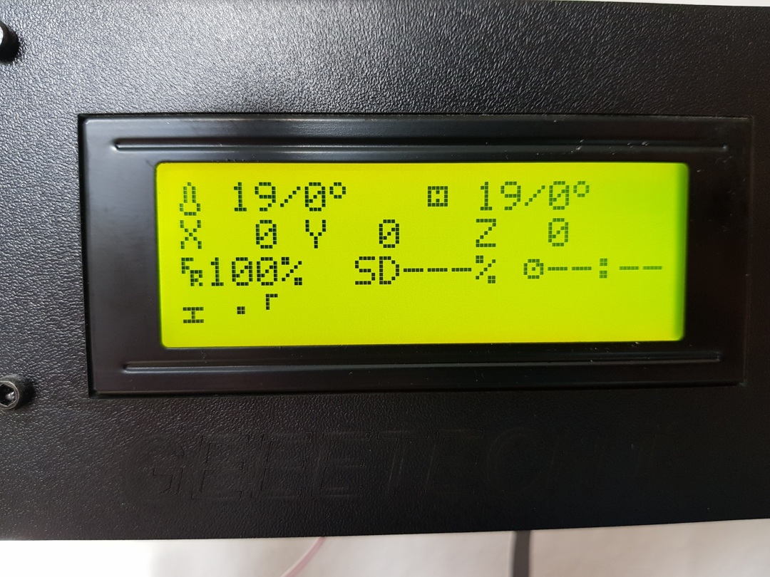

After that, I had to face the problem that I couldn't send any print files to the printer via USB, because the board didn't respond to the print job and there were only some strange letters (i. e. "%j") in the lower line of the display. I think it would be helpful to replace the board now, because I dont have any other possible error sources. I dont know much about this board but is it possible that the given facts match to a broken board? And what board should I buy to replace in a Prusa I3 Pro W Kit?

First of all the "graphics bug" when you can call it like that. It happens when I start a print via Geeetechs EasyPrint3D Application and the printer does not do anything. The only feedback I got is within the bottom line of the display like that:

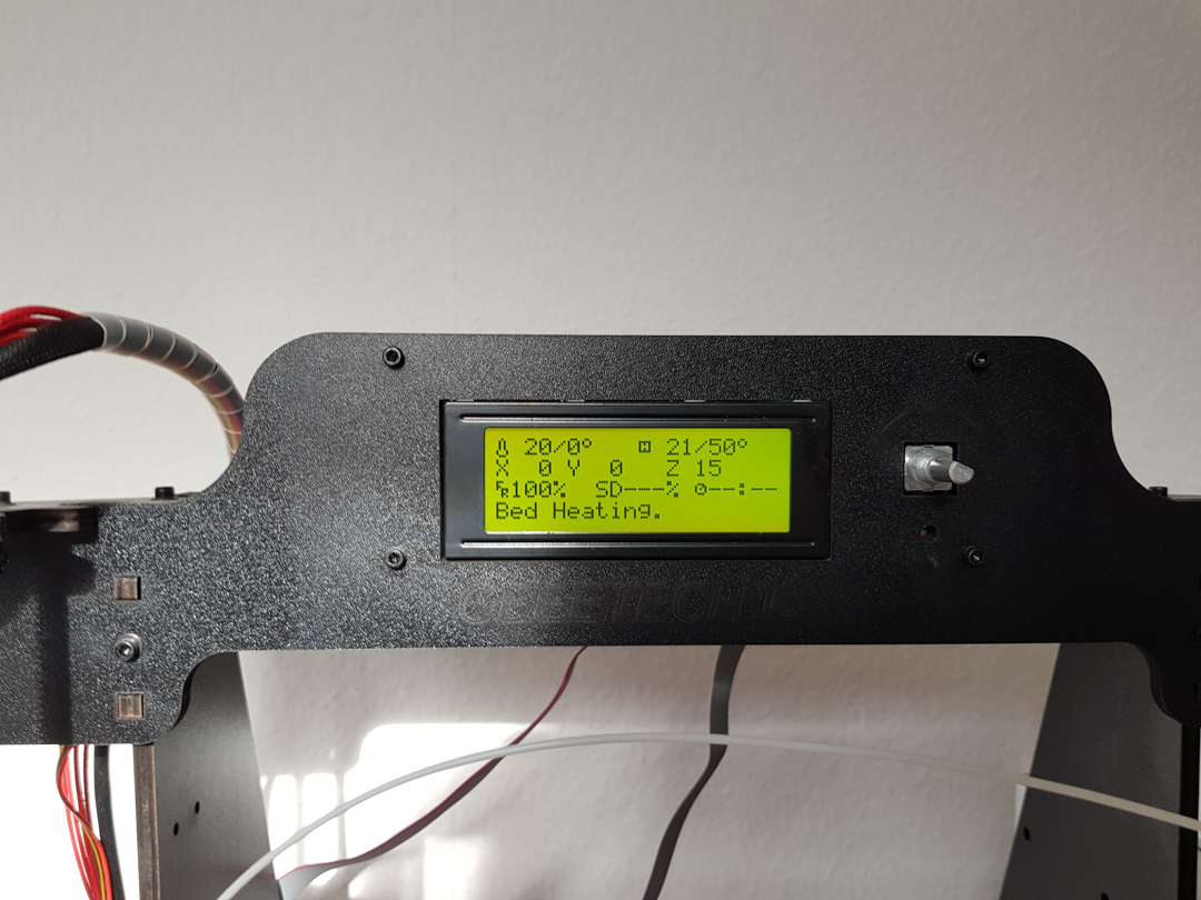

After that I tried to print with Repetier Host. The Bed started heating but the Extruder didn't do anything.
The next thing was to try to scroll through the menu. Didnt work as expected. :|

:D Hi, If you are referring to the hot end, not heating,
you can try to check if your hot end wiring is fully connected to the motherboard.
The thermistor at the hot end is then measured.
