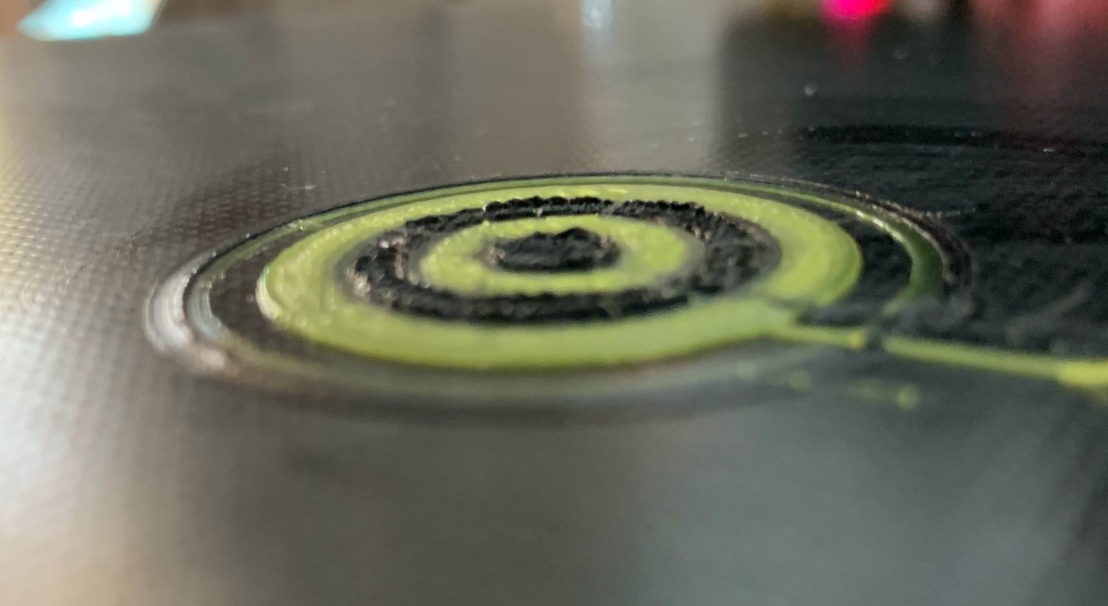

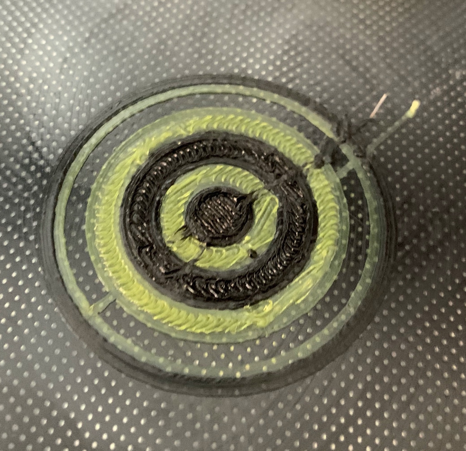

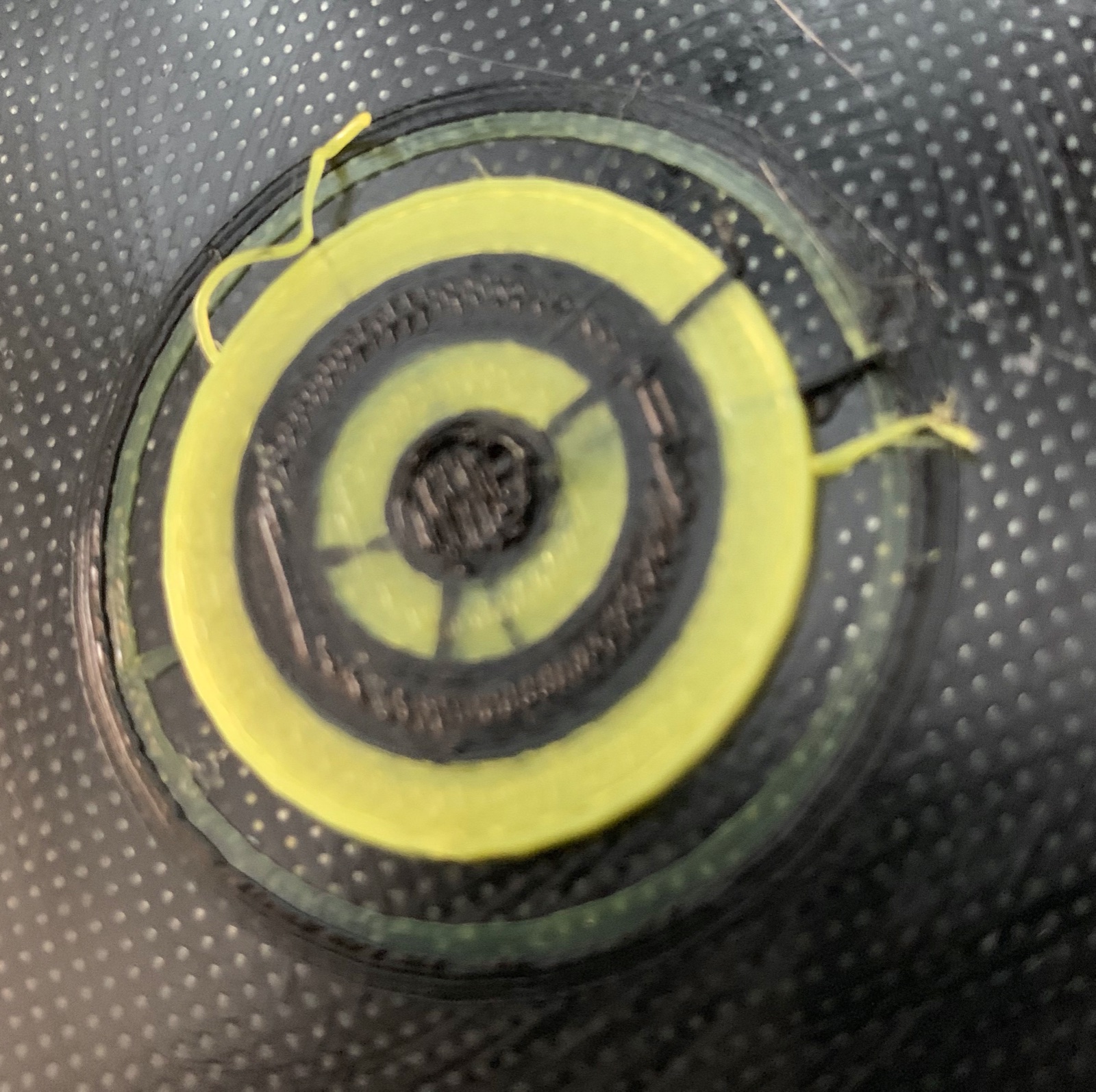

Thanks for that - have been trying to get the script to work, but it almost seems that after a purge - the head returns to the print and is good for the first layer, on subsequent layers however the head grinds into the the print (black section especially) Stringing is present but I'm considering playing with temperature and flow rate to see what the sweet spot needs to be to reduce this as the yellow seems to have gone down really well in comparison.
One thing I have noticed is the head tends to pause after the purge (after it travels past the silicone wiper) and a blob forms which seems to increase the stringing. I've adjusted the nozzle switch retraction to zero as advised (see picture) in the machine profile in Cura but left it at 6.5mm in the material profiles as I presumed the note referred to.
The end result (see picture) is better but the black PLA seems to bubble, whereas the yellow lays very smoothly... both are Geetech reels - am I missing something obvious?
Screenshot 2019-11-19 at 12.27.23.png (319.97 KiB) Viewed 12217 times
initial layer
initial layer
Initial layer profile
end result
end result
